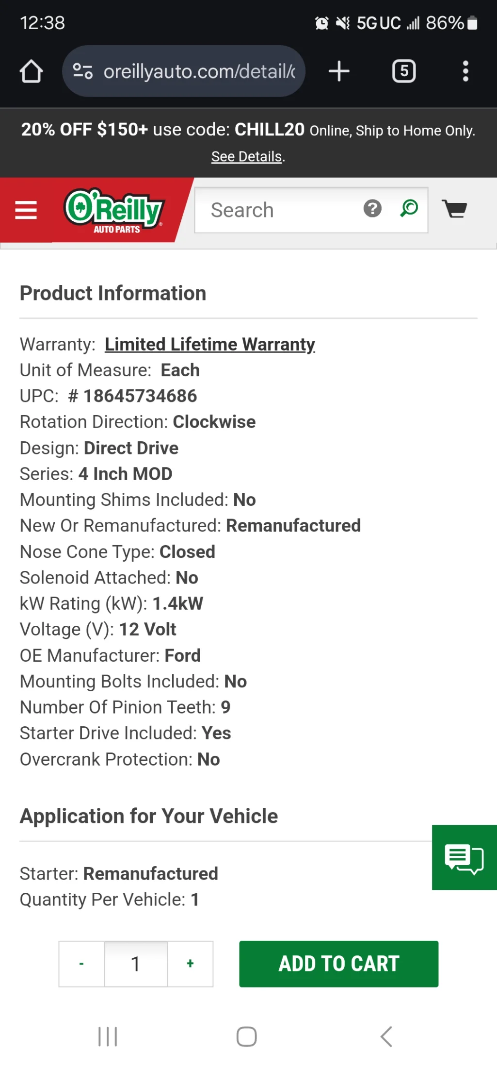

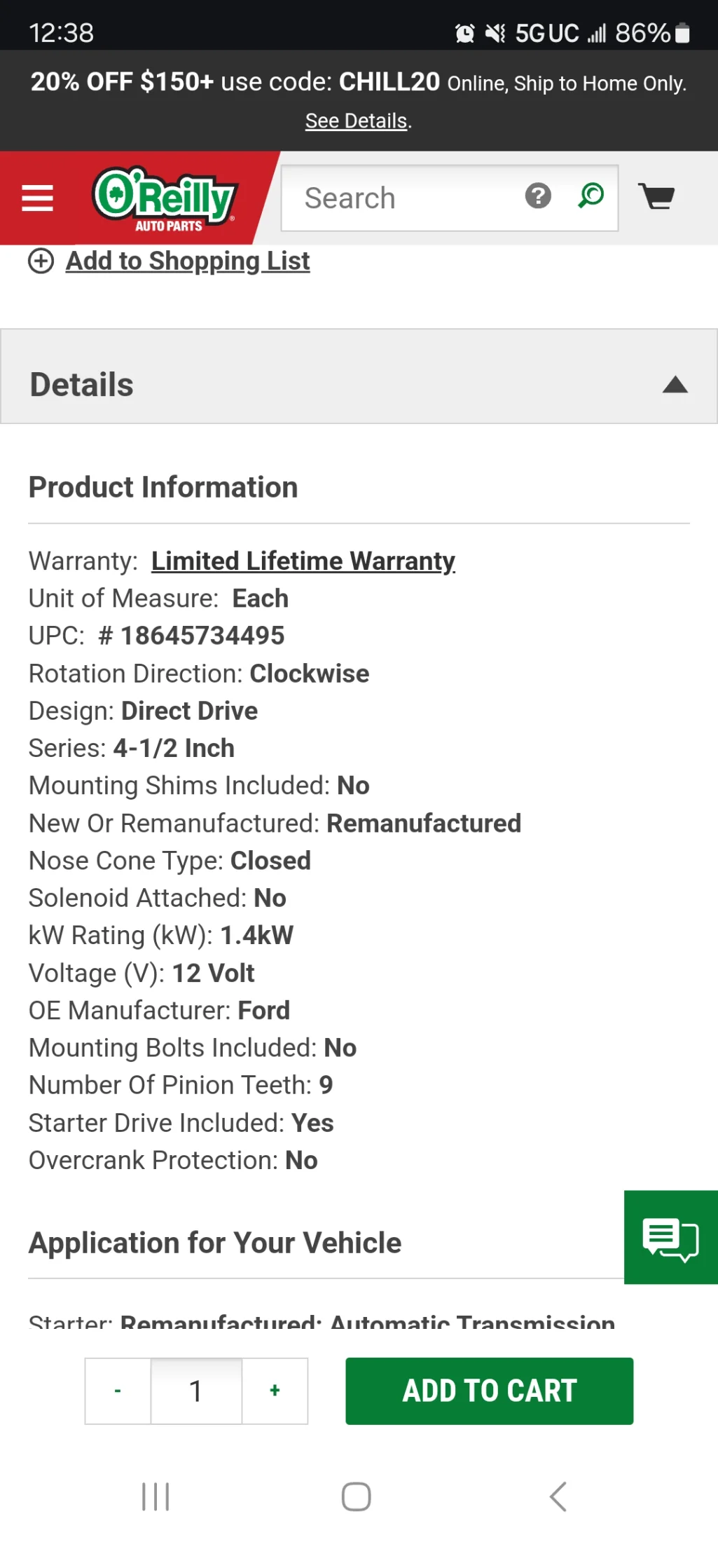

For reference - the only difference that O'Reillys lists is the "series" which I believe relates to the diameter of the starter. So they probably made some improvements to the inner windings. The 4-1/2 is for the 70, the 4 is for the 82.
