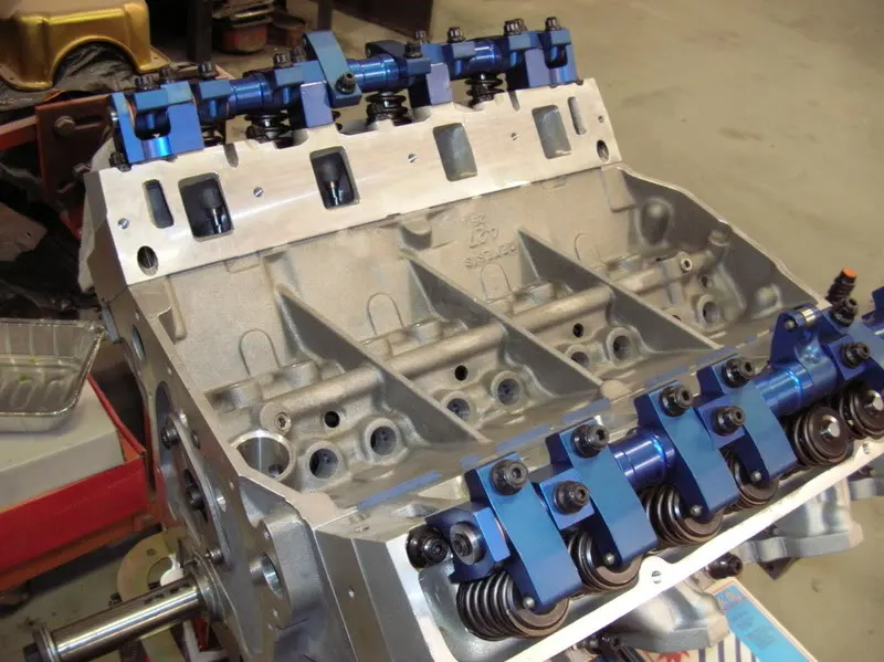

393W beats 427FE? I don't think so.
427W vs 428FE:
Testing 427 Windsor Vs 428 FE - Mustang & Fords Magazine
The 428 was actually a .60 over 390 or 422. FE made 505 hp, the "W" made 486.
Use a real 427.
