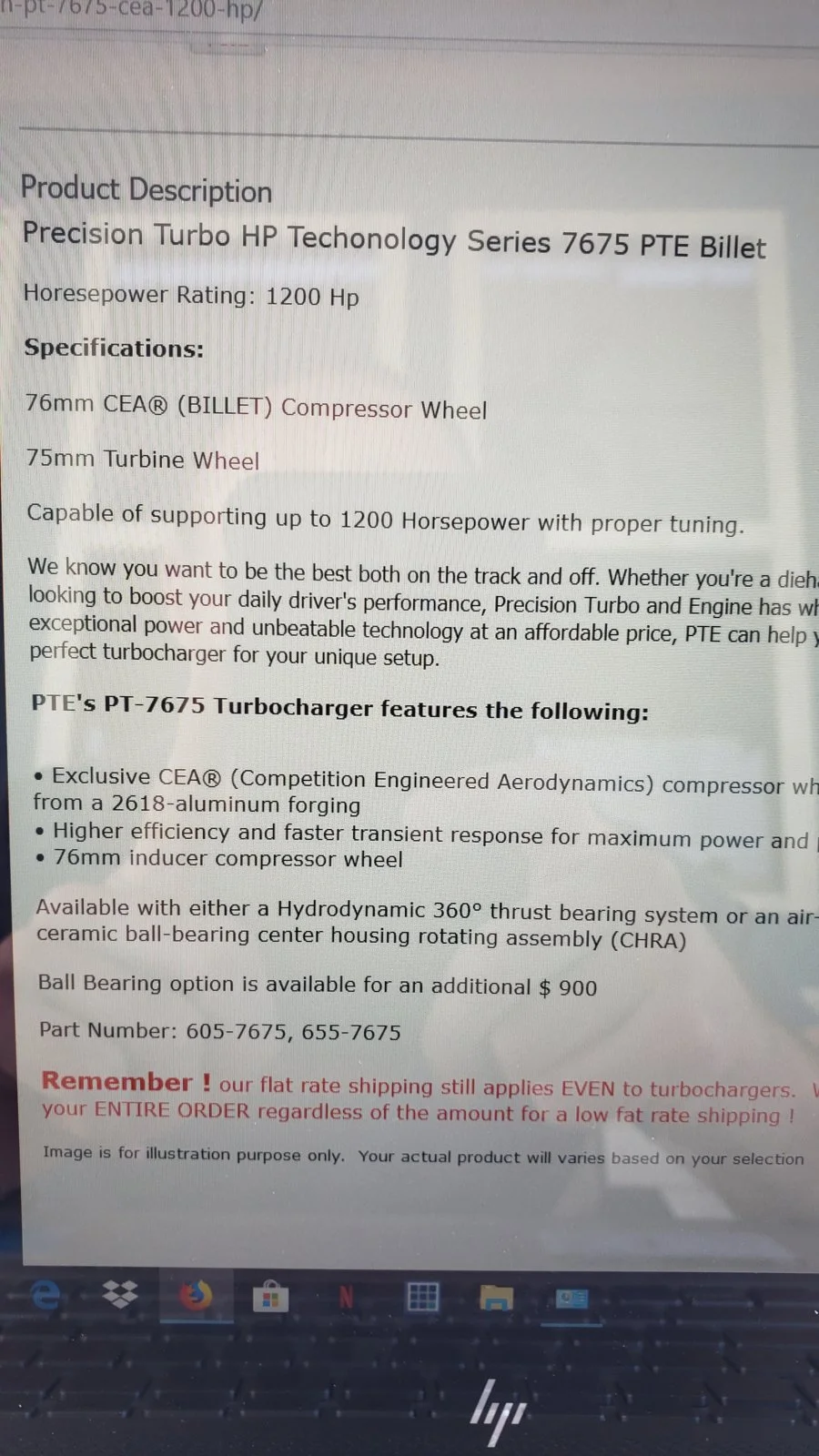

What do you guys think about this PTE7675 with. 96 housing? Can also get with cast wheel for $500 less. Do feel a billet wheel or also the $900 option for cbb will make a huge difference in spool for me?

Awesome street turbo. Spools fast, makes all the power you're asking for and more. The CBB might give you ~300 rpm quicker spool. You will build boost in the high 2k rpm range and reach full boost around 3500 give or take without CBB. You decide if your wallet can justify it for the price. I don't think a billet wheel does much that a cast doesn't.
Awesome. The offer up to a. 96 ar. Do u think that's enough for me or will I run into back pressure problems. And thank you by the way for helping me out. This has been great
