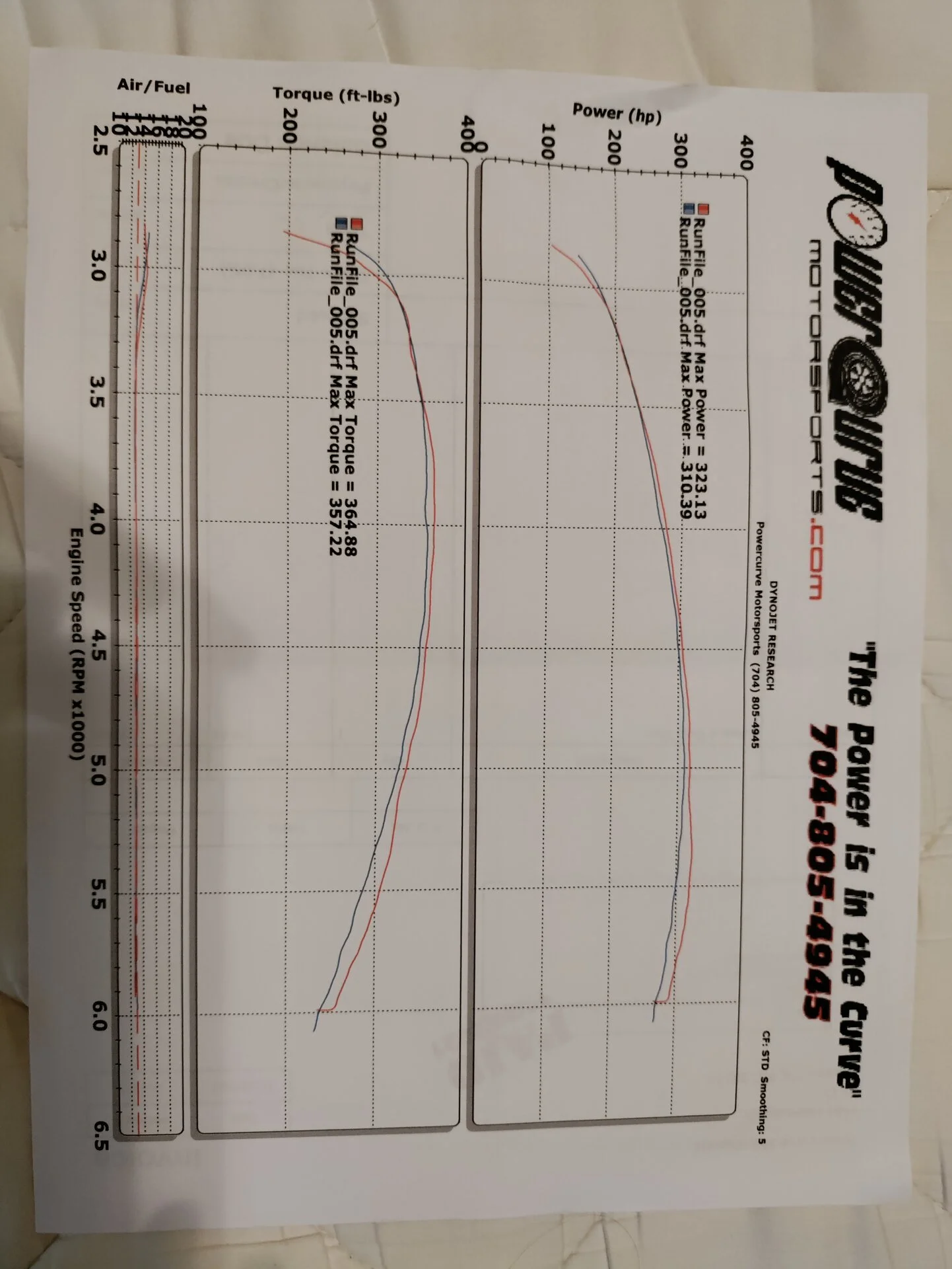

I included some pulls he made while he was tuning it

What's the dyno curve look like up top without smoothing? I'd say its about average for box stock parts threw an aod, pretty much 302 parts on a 347....... Liberty heads are the China dart clones everyone sells now, decent budget head but port work helps a lot if your going after hp na in my opinion . Exhaust ports ain't that great as cast. Same casting as the afr enforcer but much cheaper valve train if bought asembled from liberty. Springs maybe to light for the cam in most cases but the dyno should show that. The elgin 1836p is pretty much the first gen Tfs stage 2 grind old part number was TFS-51402001

Also just curious, what would show in the curve if the springs are too light. It's possible he bought them unassembled and installed his own springs
