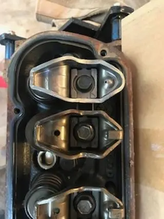

Finally got around to buying a Melling 351C rocker arm and mocking it up on my explorer engine. In summary, this isn't going to work, but I wanted to show pictures of why it won't work. Hopefully, this will answer any future questions on the possibility of swapping 351C rocker arms to get the 1.73 ratio on a windsor engine. Pic 1 shows the physical size difference, Pics 2/3 show the valve tip/rocker arm contact at no lift and full lift, with the 351C rocker arm only making partial contact on the valve tip. If this situation didn't break something, it would certainly cause rapid guide wear. No amount of shimming on the pedestal would correct this misalignment. Pic 4 shows the windsor rocker with the correct rocker arm/ valve tip engagement. On a positive note, I tore down my explorer engine after I did the mockup and it still had the factory cross hatch on the cylinder walls and no evidence of guide wear on the GT-40P heads. I was blown away how clean the motor was on the inside. The #3 main bearing had very little wear. I may just put on a new oil pump, re-gasket, add HP springs ,small cam and run it as-is until I can build a 347 with my Mustang block.
That's what I said above...
