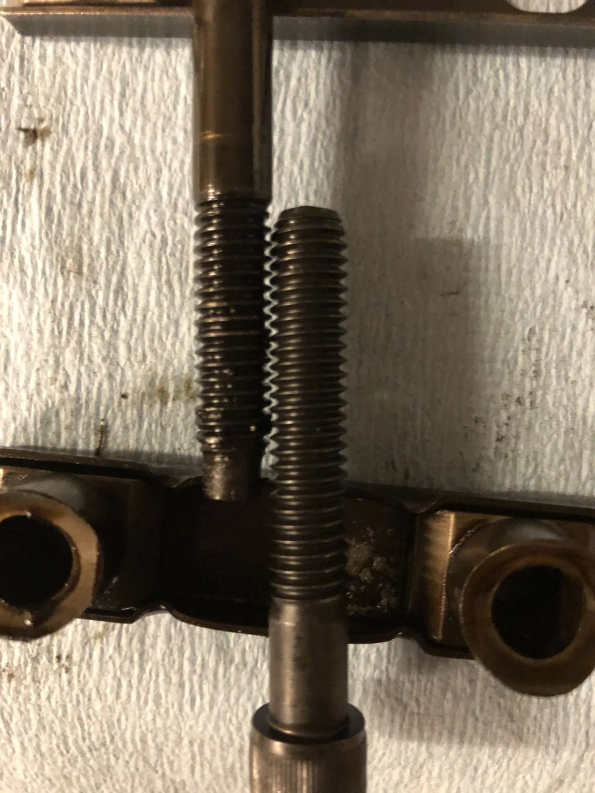

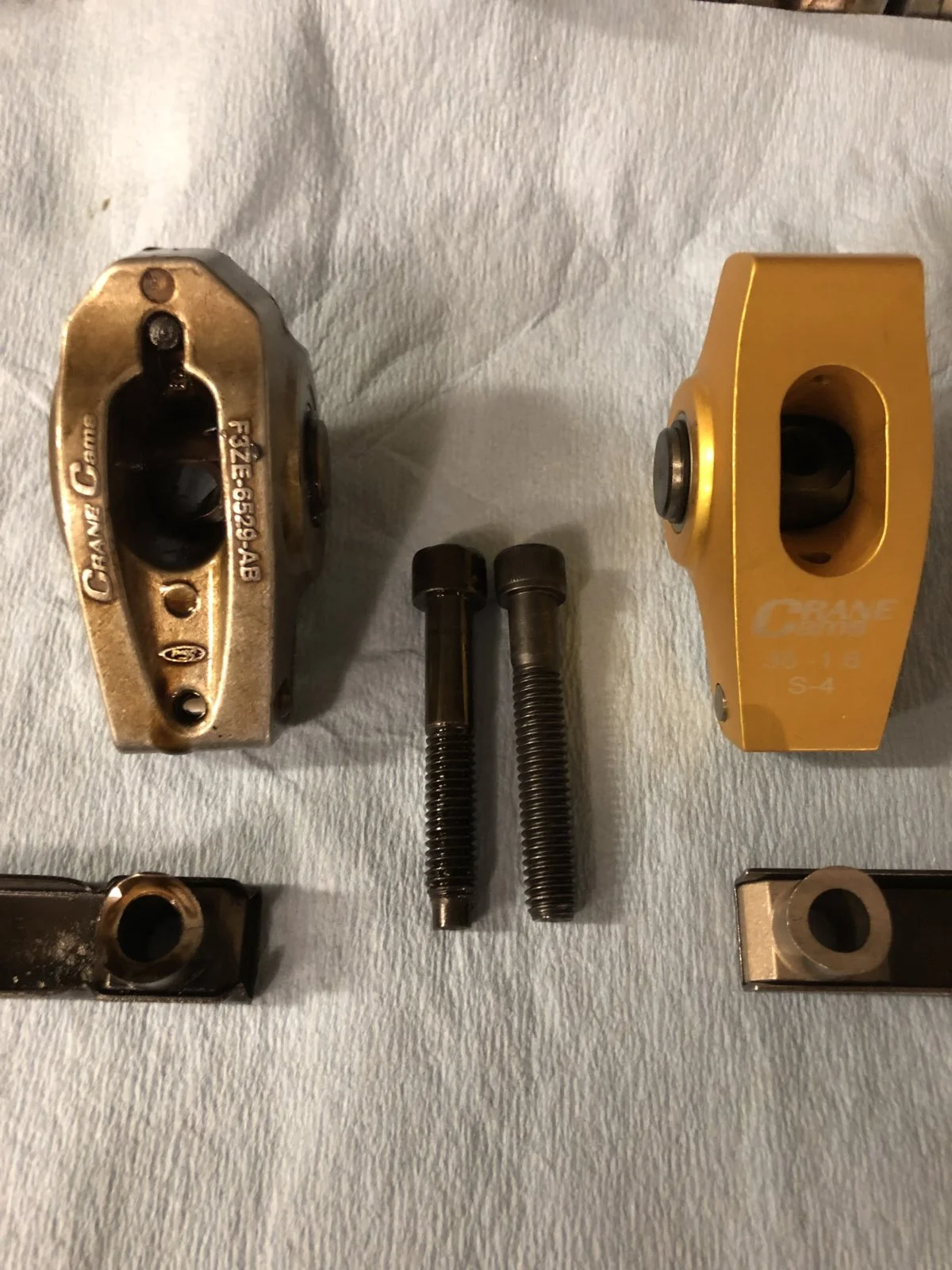

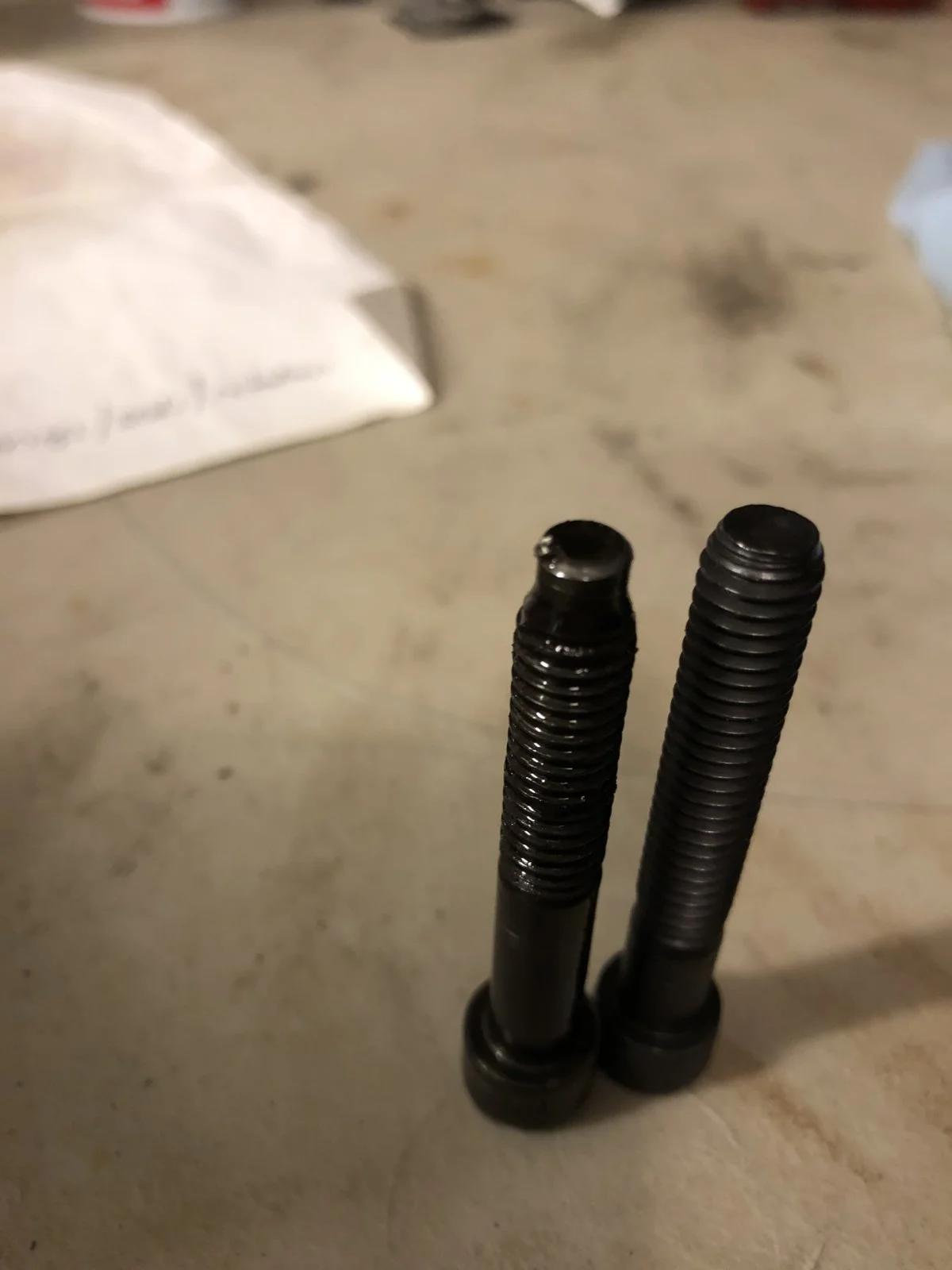

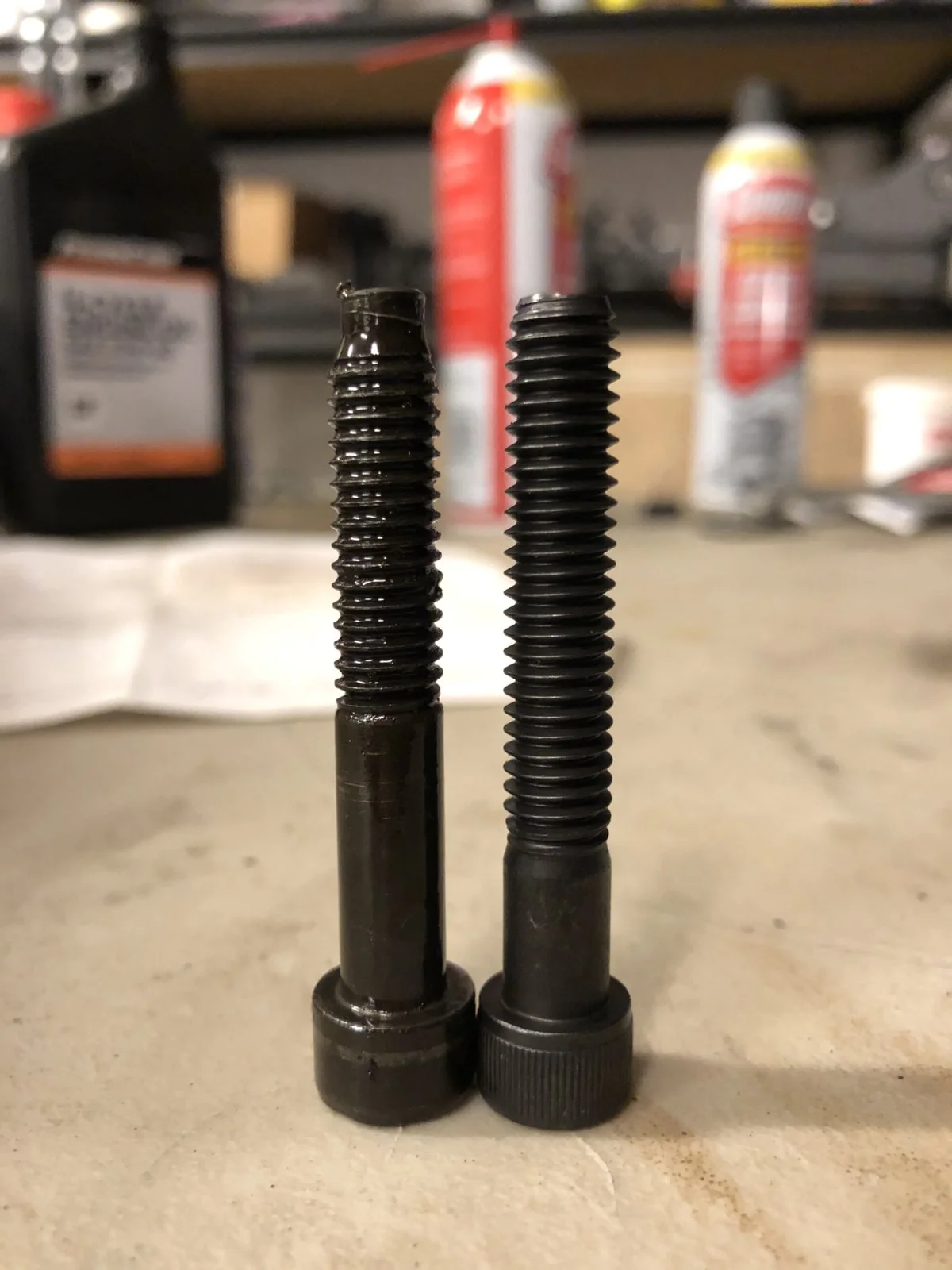

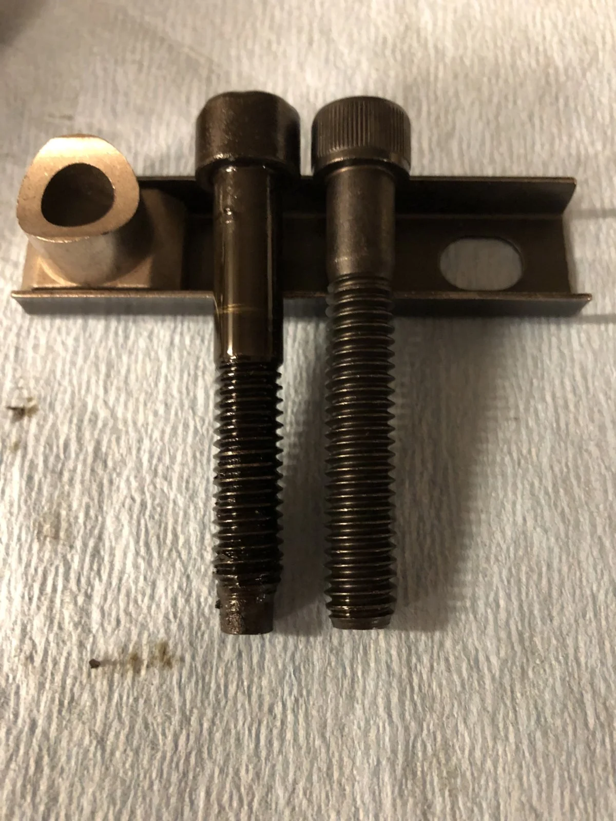

Upon further inspection, I do believe the bolts are the same size. The stock bolts do have a taper on the tip to guide them in whereas the new ones do not.

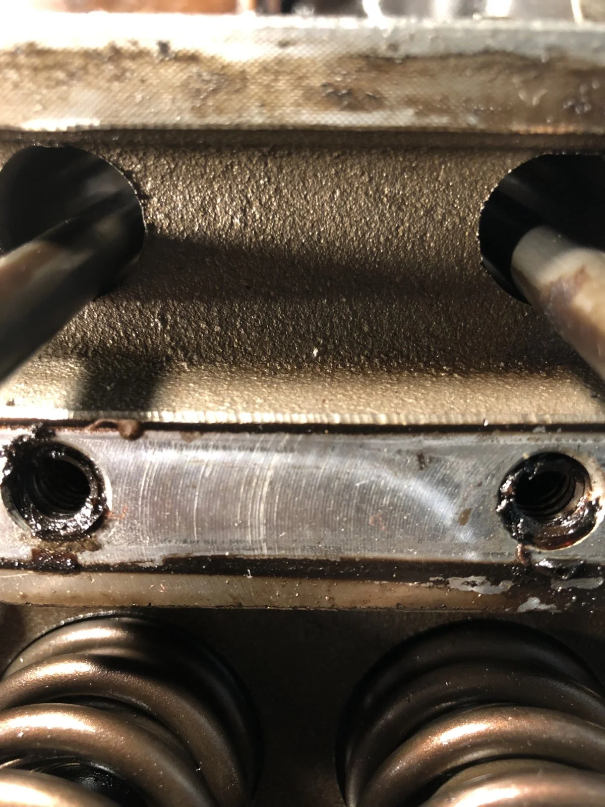

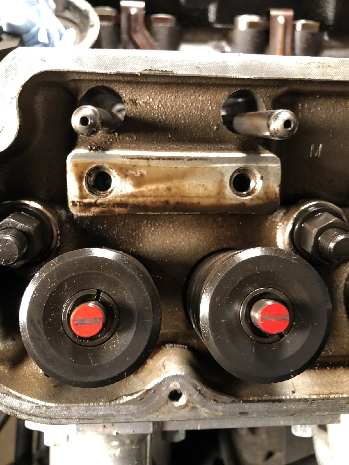

I’ve noticed something at the mouth of each rocker bolt hole, possibly burnt oil or old threadlock? In the pics you can make out the black hard material that’s breaking up and preventing the threads of the new bolts to start. When screwing in the bolts by hand, I can start and screw in the old bolts without issue, tried serval bolts holes. But the new ones lock up as soon as they grab thread and then when I back them out there’s residue of that hard black material acting like gravel in the threads.
I can understand the old bolts starting easier right the taper, but if they are in fact the same thread / size bolt, I don’t see how the stock bolts don’t also exit with pieces of that same junk. Maybe the oil reside on them, or how often they’ve heated up and cooled down?
I don’t want to strip the aluminum, and it feels like I’ll do that if I force the new bolts. Also, I’d rather avoid getting in each bolt hole with dental pics ha (which I did to the bolt hole on the right in one pic). So should I just tap wash hole and oil the new bolts, or just use the old ones?
In the pics, new hardware is on the right. Again, any suggestions are appreciated.

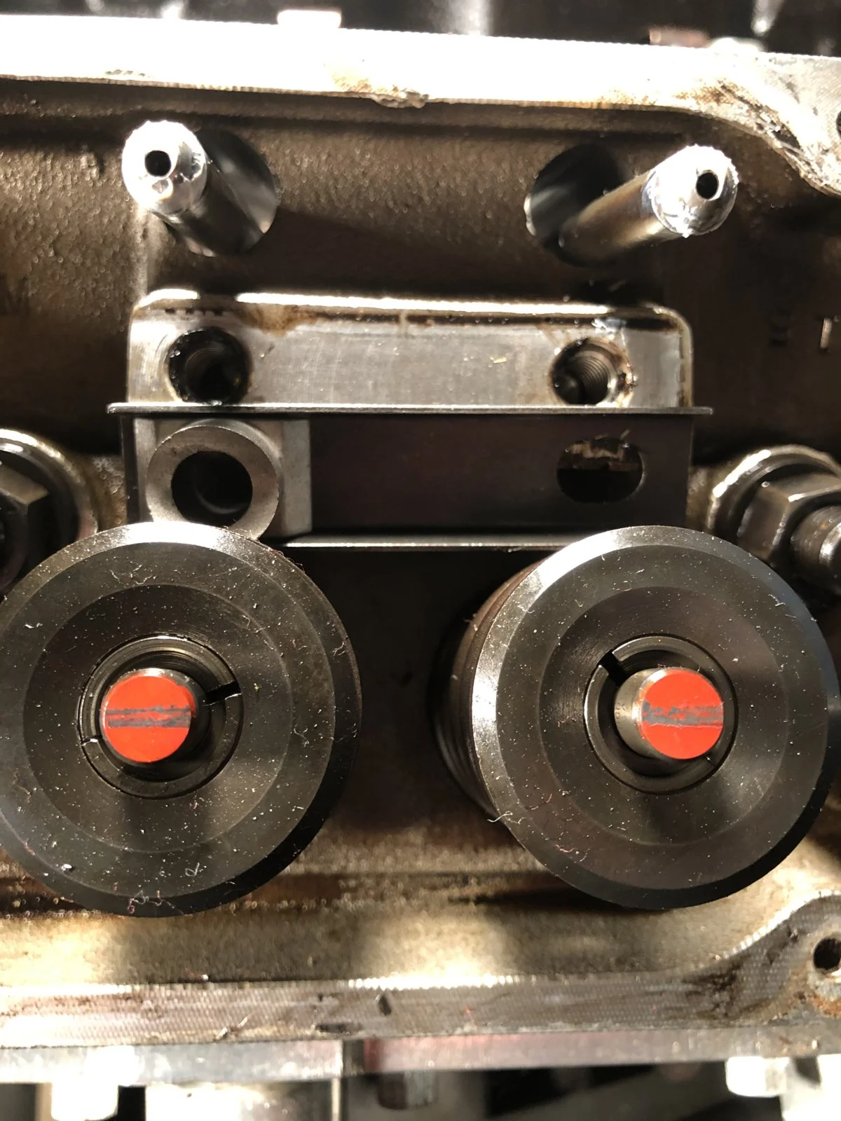

I know I’m tired because I have a two week old, and last night I was feeling pretty dumb thinking that these bolts are the same size, and just some old burnt oil was preventing them from starting. But today, after wire brushing a few holes with a rifle cleaning rod and a cordless drill, and wiring brushing the black anodized bolts to wear down some of the finish, as well as putting oil / assembly line and WD40 on a few, I’m back to thinking these bolts are different sizes.
I’ve only got one new bolt to start and screw in, which gave me hope! But Every other hole seizes on the first thread by hand. Everyone one of the old bolts starts without issue. They’re so close in size that they’re hard to believe they’d be a size off - possibly one is standard and one is metric they’re so close.
Frustrating!
Attempting to measure the bolts didn’t pan out so I used the original bolts. When torquing and shimming the RRs I noticed the stock bolts were coming out scarred as I guess the new pedestals and RRs aren’t as tall as the original (pic below). The new bolts I gave up on using appear to be a hair shorter, but their bolt head is also slightly shorter.
And now my valve covers contact the new Crane 1.6 RRs... fun!
