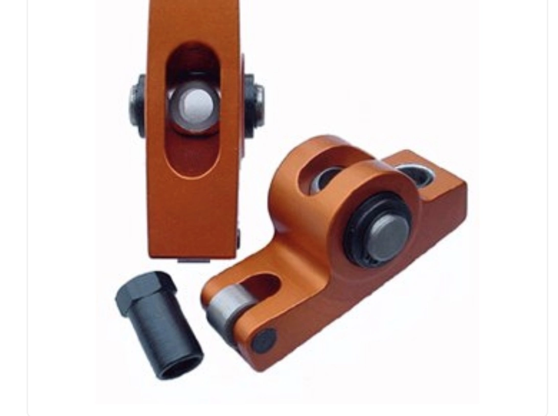

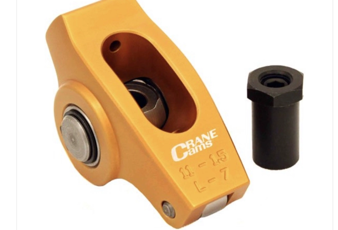

Few pic’s...in order.
Cranes Gold series, Harland Sharp, Comp’s pro Gold, all very good Rockers. There’s better, of course- but do you need 600$ Rockers on a H.R. Street motor? No.

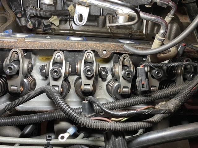

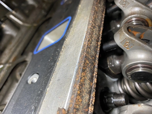

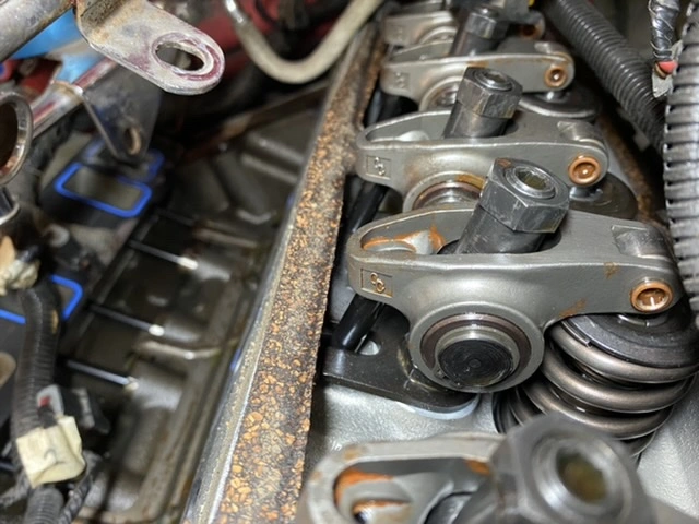

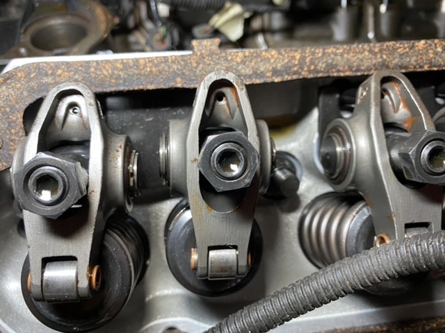

Mine

What Cam are you running, and are you running it’s Springs? Spring loads around 125-130lbs (Valves on seats (closed), 310-330lb Valve open, or at full valve lift)(?).
I’m not able to see the distance between the Spring retainers and the Rockers are when valves are closed (valve(s) sitting on their Seat(s)).. Distance appears close, can you please take a pic showing that distance (Simply a pic taken from the front of the head showing the first Rocker from a side profile?). Any interference between the Rocker and the spring Retainers you’ve noted?
Are the pins that retain the roller tip to the Rocker body hollow, or solid? May just be my interpretation of the image.
They appear to be Comp’s 1.6 steel rockers with full roller Trunnions & roller tips. We’re these previously used?
Did you set your pushrod length, or was this part of a TrickFlow top end kit?
You want your roller sweep to be </= 0.080 across the valve stems, as centralized as possible.
A dry erase marker is perfect for this, temporarily using a solid roller lifter in both the intake and exhaust sides. You can also pump up the hydraulics by cycling the pump long enough to achieve this.
Another tip is to have the Stud swing equally within the Rockers slot, from Cam base circle (heel) to full lobe lift is desired, along with a good sweep pattern across your stem(s).. If you’re still in need of an answer, I’m happy to help!
