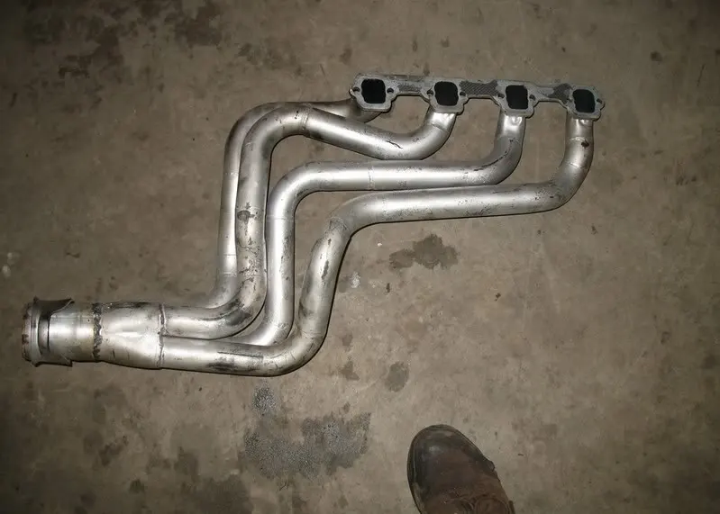

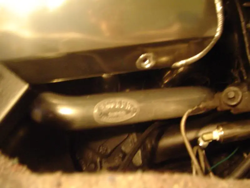

I know that Accufab changed their part # system since I bought mine 7-8 years ago, but don't know if they changed their product. If your driver's side #1 pipe sits as low as the one in the pic, you will probably have the same issues:
That tube even hits the 65' factory MM, which I modify and use a heat shield. IIRC, the passenger side would have only needed a small amount of work to make the Morris mount fit, but the driver's side needed tons of work. Still the passenger side has a similar low tube:

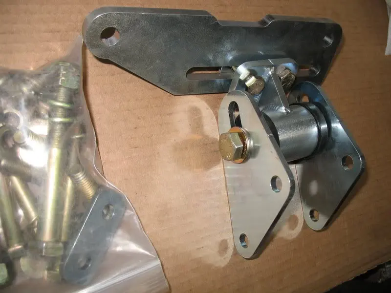

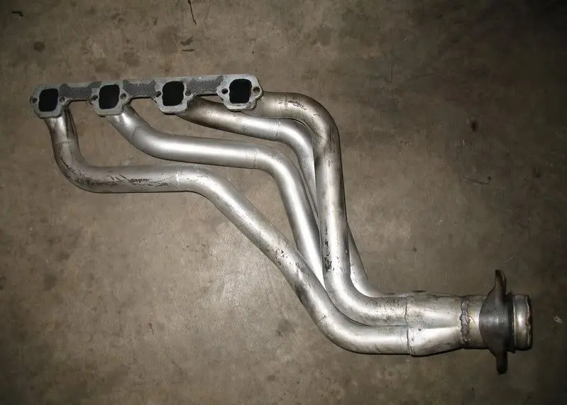

Here is the fully adjustable Morris mounts that I tried:
One of the Stangnet members snagged them from me in the classifieds.

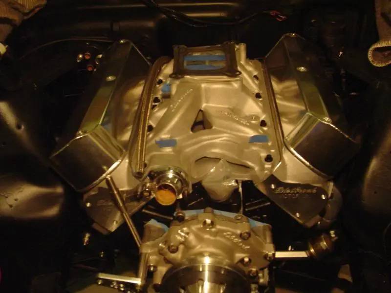

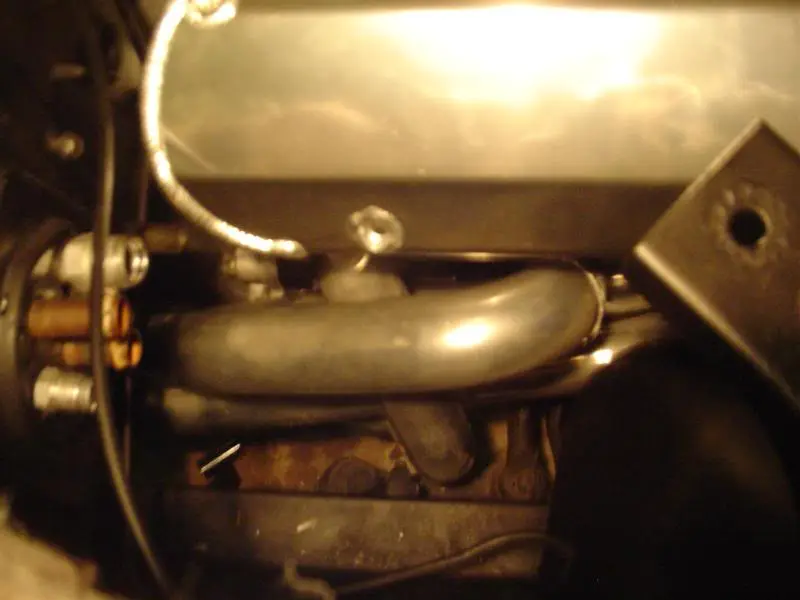

LOL, at this point, the Mustang II front end could be the worst handling thing around, but the clearance would be a wonderful thing.. I was able to get the headers in, but now they are touching both sides.. SO.. torch and hammer are coming out. Going to move the headers slightly to where they need to be. kinda at a loss for the moment. From the info i have, it seems that between the aftermarket mounts and victor jr heads, the engine is just too high. Too late now, i need to get the car ready for pinks in a few months. ill do what it takes this year.

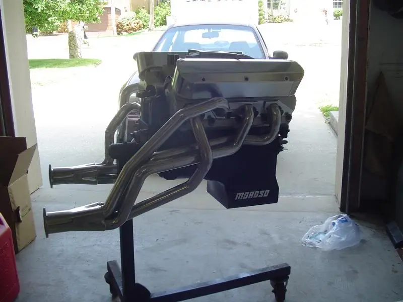

I have a very similar setup to you. Same motor mounts, Victor Jr heads. I actually used the Hooker Super Comps with 1 3/4 primaries. They were a great fit! I only ran into issues becuase I decided to push my motor as far back as possible on the adjustable mounts. If you have any questions about the swap let me know Ill do my best to assist.
I found a couple of pictures of the headers I used. Also...don't use Moroso pans! I learned the hard way, I ended up spending the extra and going with a Canton T-pan.
I had to "massage these ones a little"
I looked at those headers, and will probably go to something like that due to the bigger primary. I too pushed the motor back, but for these headers and mounts, it was the only place it would really fit. Thanks a bunch for your input. Its sometimes hard to find someone that is even close to my setup, so i appreciate it.
Just curious, were you able to put the hooker headers in while attached to the motor? Or did you have to take them off?
I installed the motor and then put the headers in from underneath. It was not very easy...it required moving the engine around quite a bit on the adjustable mounts to make room for them to initially get in the right spot.

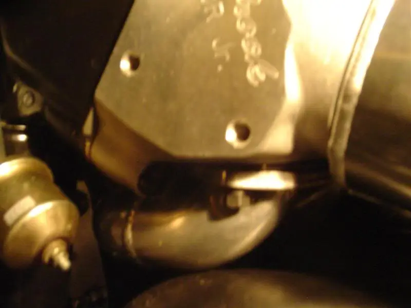

He does have the RM mounts like me. The tower notch is more for the spark plugs then the exhaust. Ill tell you the tubes come out right at the bolts for the upper control arm. So the only way out of that is Mustang II swap or some other suspension that allows notching. But a 408 would be sweet.. This winter, if i can, im going to build a Dart based 408 with a YSI going to it.. And see just how fast this 65 can go.

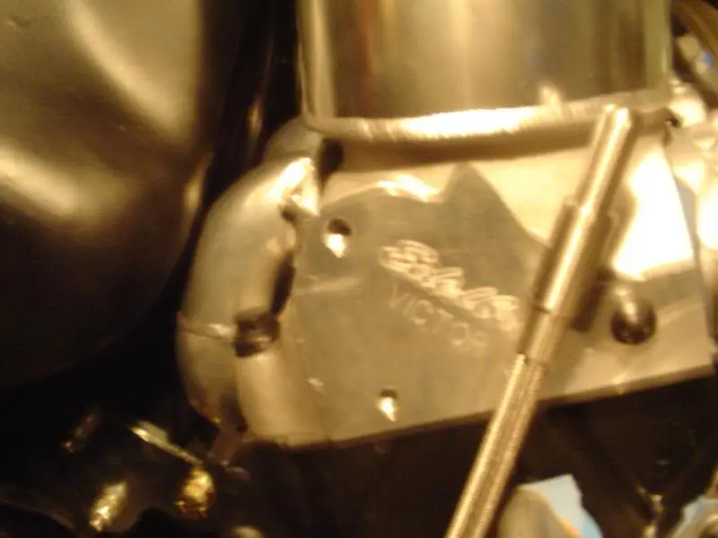

you can notch for the header tubes too. Well at least I think I did. I looked at Dennis' pics and it looks like the headers almost touch at the front and rear of the towers (like the pics above); kind of where it "bubbles" out on the tower. I cut the bubble out and then made that area more flat. Before I did it you could fit a little more than a finger behind the UCA, now there is about 1/8" of clearance behind the UCA. Looking at it in the engine bay you really can't tell right now, but I think I'll have about 1/2-3/4" more on the outside of each header tube in that area, than had I not done it. Was it worth it, I don't know. When I get the motor I'll post pics and we can compare to see if it is different. I think I am screwed on the Ron Morris mounts.
