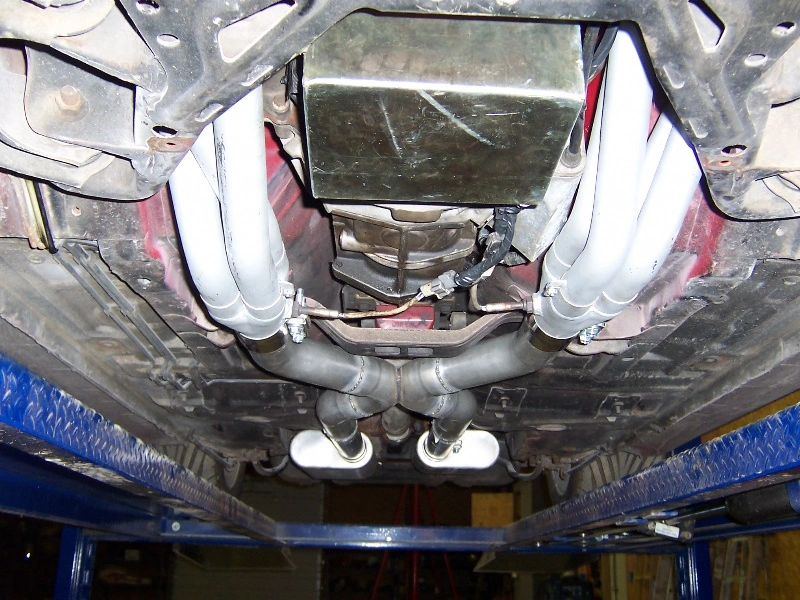

The Kooks headers use a slip on connector, so I just went with the Kooks universal x-pipe. It's a cut-to-fit piece and it eventually fits very well, after the cutting and welding. I love the slip connectors, it only takes a minute or two to remove the x-pipe.
Here's a pic of how mine turned out.
