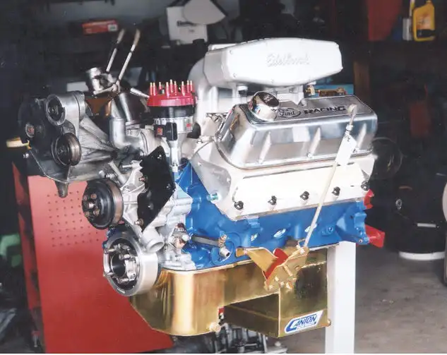

I like the fuel injection,for me its easy to tune.i went the 351/408 route in my 91gt
It probably would have been a little cheaper to carb it ,but i suck with carbs.lol.

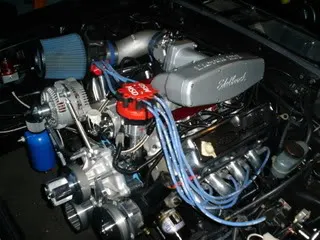

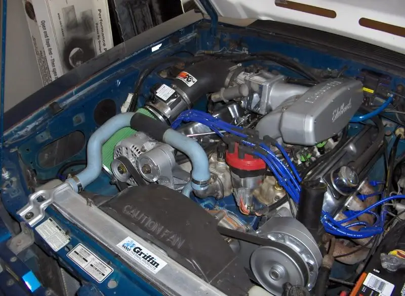

id go EFI...your car already has it. i didnt go crazy with my parts and mine makes enough power...could i make more power by changing some stuff out? yea....but it has enough for me. i replaced the fuel pump with a 255 in tank ...stock lines/rails
for the money you could get a 408/410 short block and build it to your budget and as time and money permits upgrade stuff.....
P.S. make sure to use ceramic coated headers :doh:
