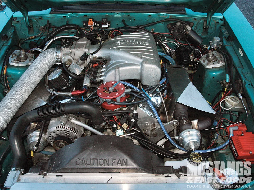

I've been trying to hunt track down the performer RPM II intake for the 351. It looks identical to the one used on the 302 and every time I search for it I always end up with those carb intakes or 302 intakes. Does Edelbrock still make it? So far all I have to go by is an article in a magazine of a calypso green fox body making over 1,000hp with a turbocharged 351 stroker using this intake.
Thanks for the replies. The performer series are their milder stuff plus that's a truck manifold. The one I'm looking for looks identical to the Performer 5.0 RPM II manifold and even uses the same upper plenum except the bottom is for the 351. It's street legal unlike the Victor and has provisions for egr.
Thats the one I posted. Only difference is the lower. The upper of the Victor and the RPM's are the same.
Its not listed for a Mustang b/c there is no Mustang that came with a 351 other then the 95R. Summit only lists parts that it was actually made for. I have that exact same manifold on mine as well as many other people.
FYI there is no provision for a PCV so you have to have proper ventilation.
This is the intake I'm talking about. It's on a 1,000+ hp 351.
I remember reading about that car before when it was in the magazine a few months ago. All I can tell you for sure is that the Victor 5.8 is the only Edelbrock intake that is designed for a 351 that will fit on a Mustang. Its not listed under the applications b/c the 351 engines that ford produced were truck engines at the time other then the 95 Cobra R and its such a limited run that summit does not list it on their site but it does not mean it wont work in a mustang application b/c Truck blocks, Van blocks, VS Mustang blocks are the same. Most of the 351 engines you see being used here came from a truck or a van. Other then the 95 R there are no factory ford 351 blocks.
