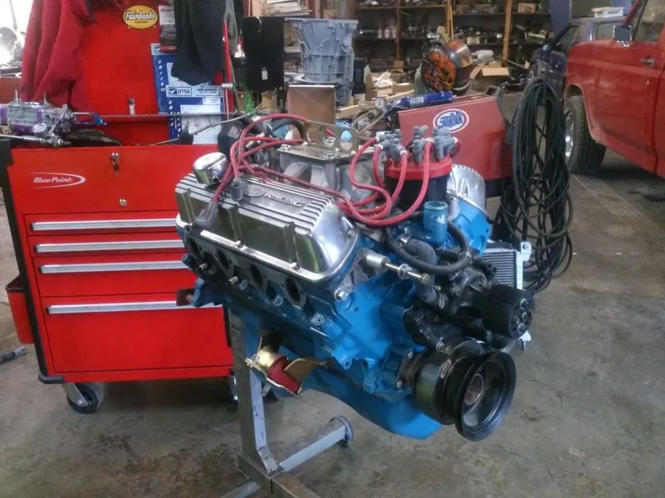

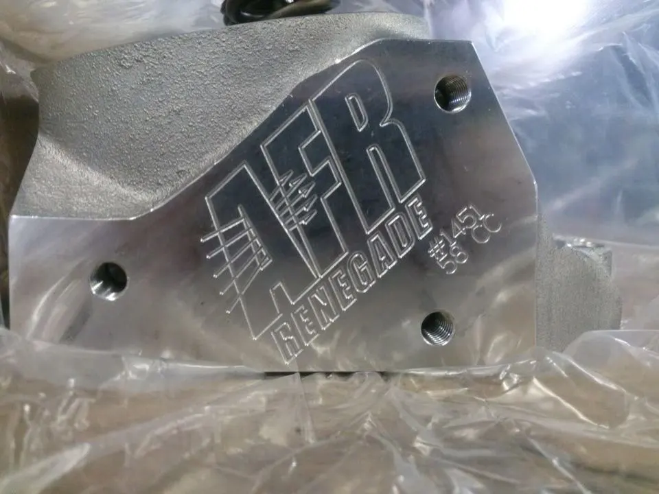

Some of you may remember months back when I posted some videos of my dads drag car, if not, it's a 96 V6 car with a 351 that he swapped in. Currently has Lunati .580 lift cam, 1.7 rockers, and GT40P heads. So basically the top end is not mixed well at all. He lost interest like many of us do but he's now gotten back into it and has ordered the heads that this engine deserves.
http://www.summitracing.com/parts/afr-1451/overview/
They should be here Monday or Tuesday.

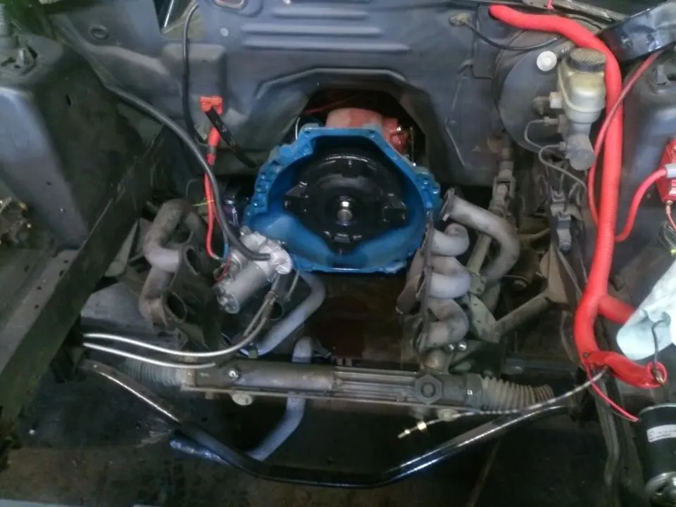

We already pulled the motor today and got it pulled back apart. He's also thinking going solid roller cam with it as well, I'm hoping that he does.
Anyways what's a thread without pictures? Only took 2 lol

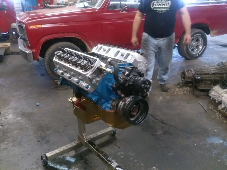

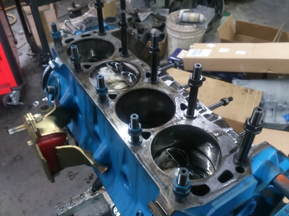

Other than the top end, the engine was pretty solid. I want to believe he has just a stock steel crank but Eagle rods and Keith Black flat top pistons. He studded the mains and also studded the heads. He built the car for nitrous and he has a 150 shot kit waiting to go on the car after he gets his new heads.
Anyways, the rest of the car is set up pretty well. Up front it has all tubular QA1 parts, Strange struts with Granatelli coil over conversion. Sub frame connectors and full roll cage. Out back is has double adjustable Granatelli upper control arms and adjustable lower control arms with Strange shocks. And of course just an 8.8 out back but has hardened axles and 4.10's. Also he built the C4 in it and has a 3200-3600 stall converter in it so it's going to launch hard. I keep trying to convince him to get torque box reinforcements but he says he'll do that another time. Probably when he rips the rear end out of it lol.

Sounds like a nice combo. I'm hoping your PTV clearance will be good and you don't have to disassemble the bottom end to cut the pistons. We have a similar combo with a few more cubes that runs bottom tens on motor and well into the 9s on a 180 shot. Good luck with it!
Reactions: 88LX5.Oh
This is what I like to hear. Lol. He was thinking the old set up was already a low 10 second combo but I didn't have the heart to tell him his combo was missmatched and probably wouldn't make power passed 5500 RPM lol. And I'm thinking the pistons will need to be fly cut more. The pistons already have pretty big valve reliefs but still, 2.1 intake valve size is pretty damn big.

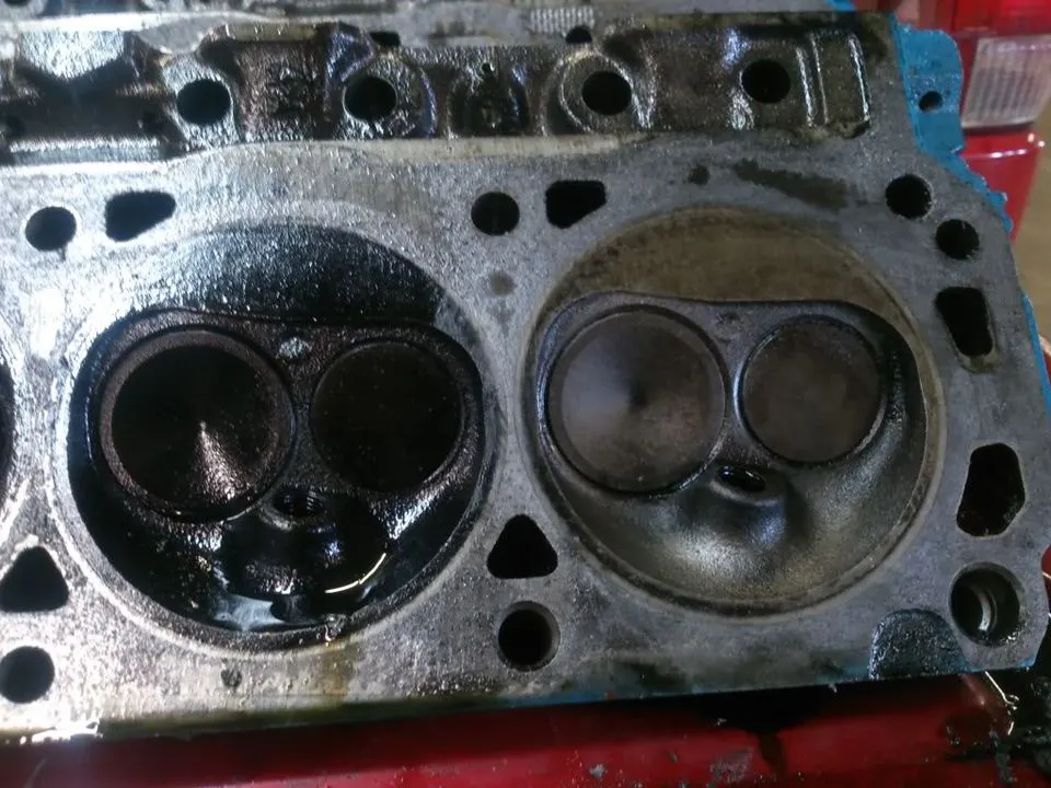

Cleaned his old heads up because I'm going to put them on my truck. He had an 850 carb feeding this motor. As you can see, it ran rich.
The right combustion chamber is the one that I cleaned up and it's still not all too great looking lol.

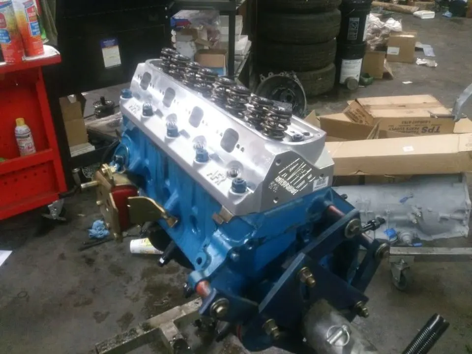

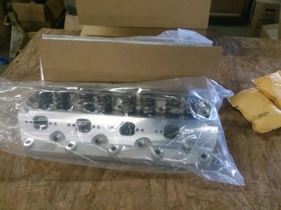

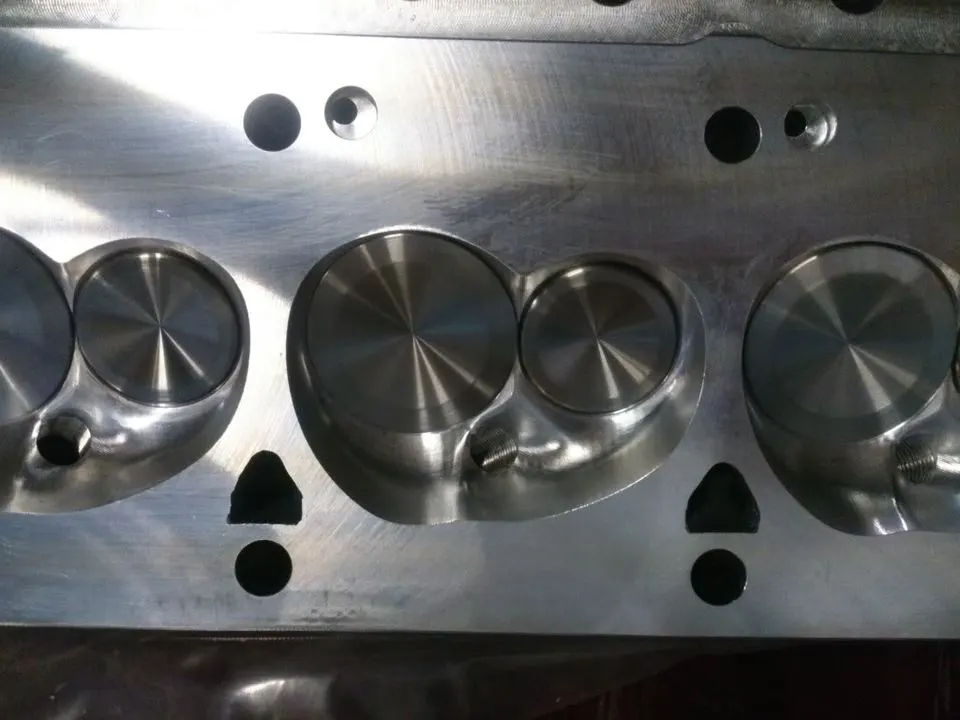

His heads did come in today and they are SWEET

2.1 valves are massive
We got both the heads on tonight. Waiting on him to order rocker arms so we can measure for pushrod length and check PTV clearance. The guy who did the machine work said that we "should" be okay since the pistons have pretty big valve reliefs but I'm doubting it right now. We have to wait until dad gets his Summit card paid down a little before he can order rocker arms

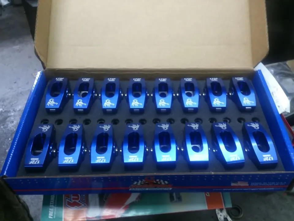

Just waiting on rocker arms and then have to check for pushrod length. After we get that then we can check PTV clearance, I really hope it clears because I know my dad will be pissed that he put both heads on just to have to take them back off :lol:
You'll never guess how much he paid for that Milodon pan and sump either.
Scorpion 1.72's

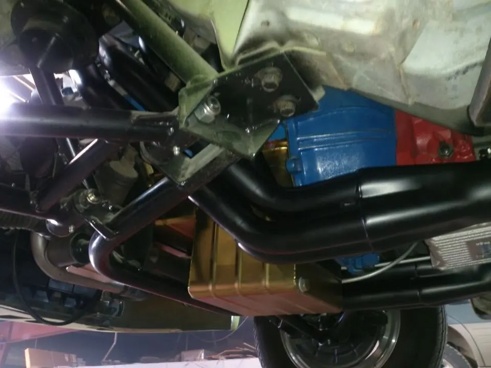

Finally got headers for it though. Team Z headers
they were supposed to be 1 7/8 but it honestly seems like they're 1 3/4 because they use the inner bolt holes on the heads, and then about half way down the primaries they step up to a bigger size. I never bothered measuring them though.

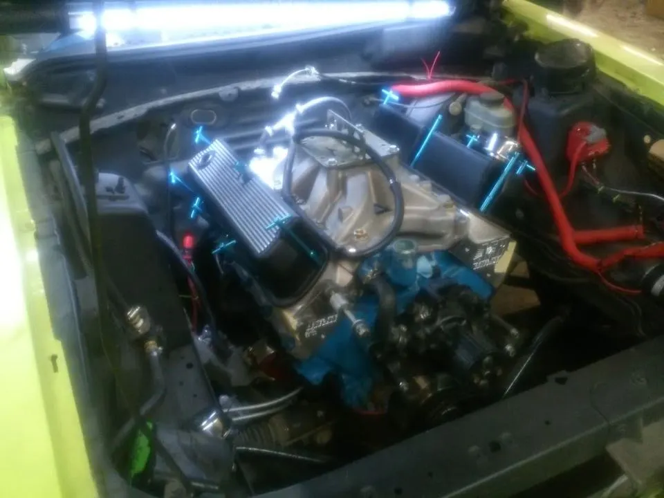

Waiting on a jet kit and motivation to get it all back together haha
