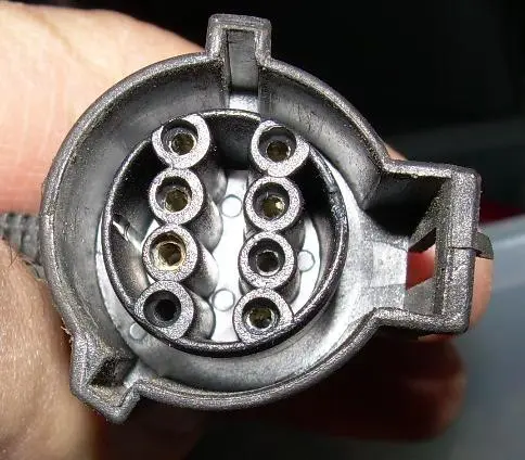

looks like this?
looks similar, but I counted only 7 wires. I cant remember but i think they were male pins coming from the distributor. I have to check when I get back home later tonight. Thanks for the input. I just may have to upload a pic of mine.
sorry, i should have said, "looks like it would fit this?"
my pic is of the 94/95 harness side, not the dizzy side. this was when i was looking for the dizzy that was compatible with my car. and i think the lower left hole is empty.
