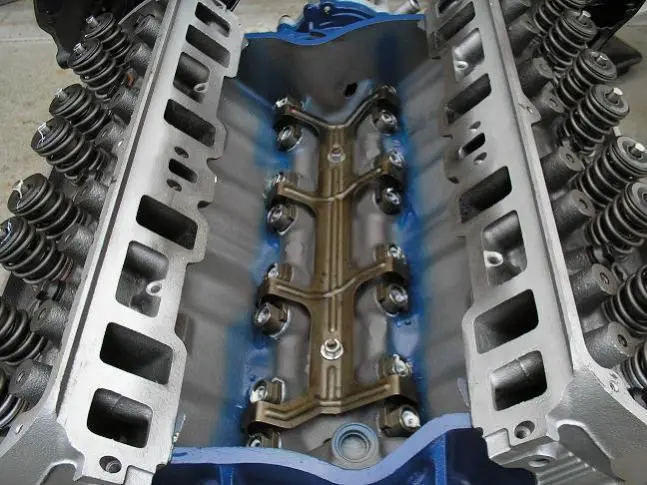

Any block will support roller lifters. To use a pre roller block you have to add dogbones to roller lifters, a spider support, and small circle base camshaft. The most work is done in drilling the block for the spider support. I used heli-coils in the block and added studs. you can see the nuts and washers, which are loc-tited in the engine. The areas around the dog-bones had to be slightly modified using a porting tool, to allow them to fit evenly.

You can go that option ^ or run the link-bar lifters and not sacrifice power by running a small base circle cam.
Edit: I'm referring to using a non-roller block of course.

On the contrary, I do know what I'm talking about, and there does come a point where you are going to sacrifice power with a small base circle cam. You can only undercut the base circle so much before you do start to run out of options, especially if you want, or need to run a high lift cam. Ok, so you have a small base circle, but you need something like .600 lift on your cam. Then what? You're still going to have your standard hydraulic lifter coming too far out of the bore, exposing the oil hole and starving it of oil. That is only a theoretical lift number above, since I don't feel like looking up the max lift on a standard cam with hydraulic lifters in a non-roller block, versus running them in a non-roller with a small base circle cam, but the point is, running the link-bar lifters is still a better idea. In most street combinations, running a small base circle will probably be perfectly fine, but it does limit your cam choices, in the way of being able to pick up something halfway decent off the shelf.
