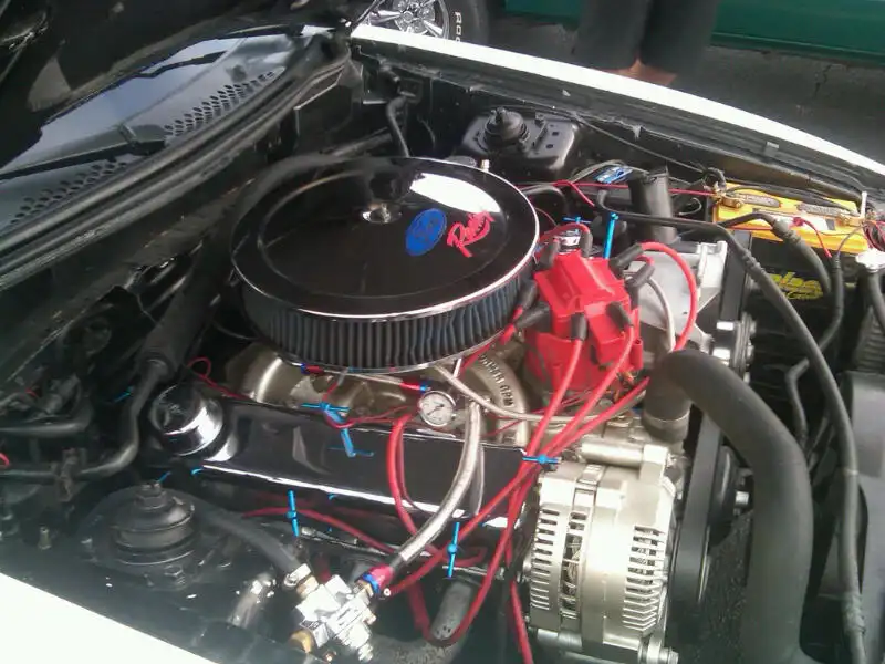

I have a picture that I am looking at on my phone and the bottom of the filter is prob an inch or so above the bottom of where the distributor mounts.

Perhaps I'm being obtuse but I think the concern is whether or not the engine between the shock towers is a 351W or a 302, both of which are Windsor engines. Since both use (or can use) the same head the number of valve cover bolts may not tell you much. The 351W has a higher deck height (to allow for the 1/2-inch longer stroke.) You need to look for the deck height differences as mentioned above.

Its hard to tell from that angle. Do you have a front pic?
The Performer RPM intake should say 351w on it but I can't tell if it does or not.
Looks like it might be wide enough to be a windsor though.
