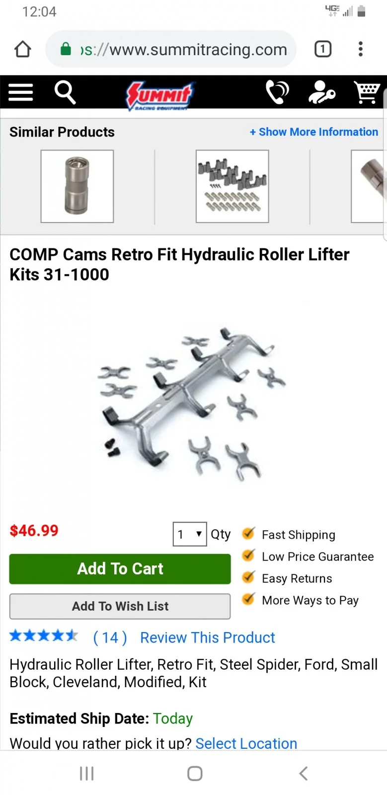

90sickfox said:
Yes... link bar lifters aren't cheap though...about 400 a set. I had a kit with spider brace and regular style lifters from ford racing....was cheaper and will work fine for a mild build.
Does the spider brace come with the kits usually, and how much power you think that block can hold, after proper machine work
90sickfox
Wasn't a pretty sight...and I've got big hands
SN Certified Technician
Mar 2, 2015
6,952
5,831
213
May 31, 2019
#32
  • May 31, 2019
  • #32
The 351 blocks are known for holding 700+ hp. The spider brace comes with the kit. This is similar to the kit i had from ford racing. The block will need to be drilled and tapped for the mounting bolts for the spider brace. The brace holds the keepers on the roller lifters to keep them from spinning. So you'll need this kit, roller lifters, and get measured for push rod length.
