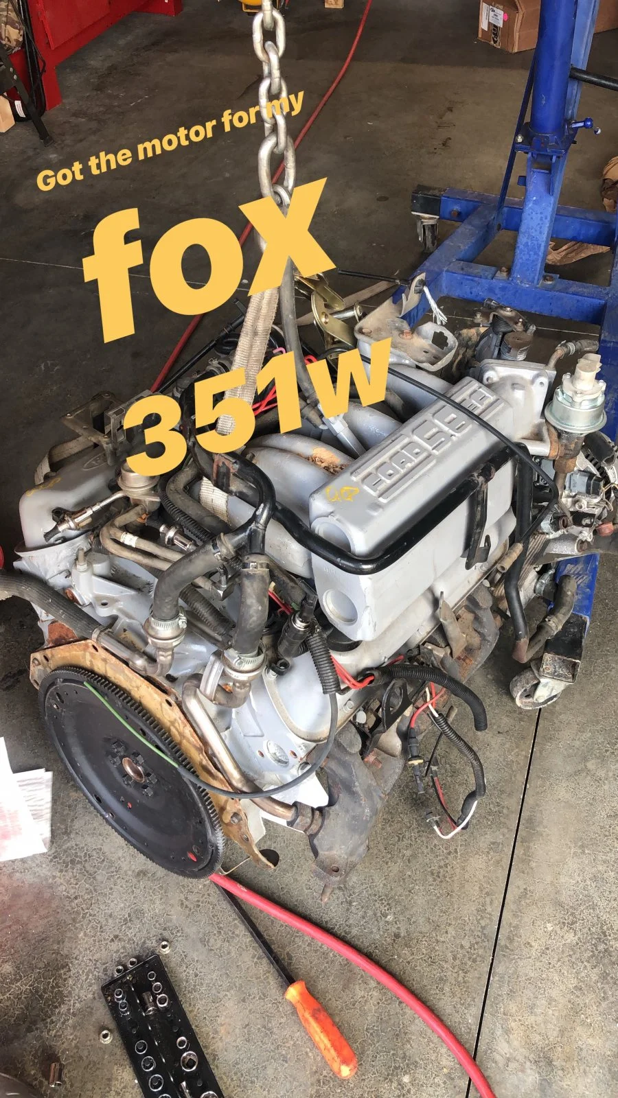

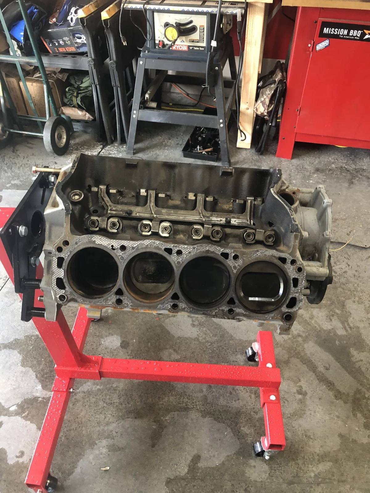

So I went to the junk yard today I found a 351 out or a 1996 f250. Pulled it and only cost $180. Roller block also
S C O R E! Not only is that a roller block, It has a roller cam. When I put together my engine I had to buy the correct length pushrods and use the lifters and dogbones and spider out of a 5.0 mustang. You just eliminated all that extra stuff I had to find... especially the pushrods.

I plan on taking the block to the machine shop in the next few weeks. This is my first time doing an all out build, what all should I have done?
Steel1
Mustang Master
Aug 18, 2017
1,419
639
143
Connecticut
Jun 2, 2019
#48
  • Jun 2, 2019
  • #48
All the standard stuff, crack check, line hone, cam bearings installed, bore .030 if building a stroker, mill if needed.

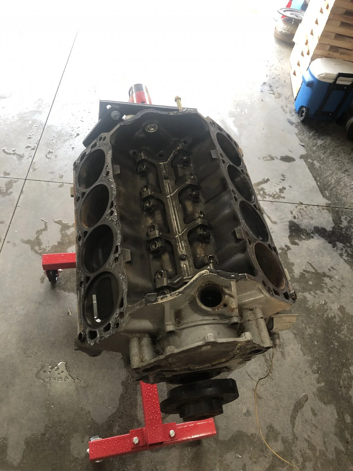

Thats a huge score. Looks like a Jasper. Check around the sides of the block for round tags that look like nickles. Usually, on a freeze plug or water galley area outside if block. Its their way of telling if the block has been overheated.
If it isn't rebuilt thats a clean dang engine...and new egr valve.

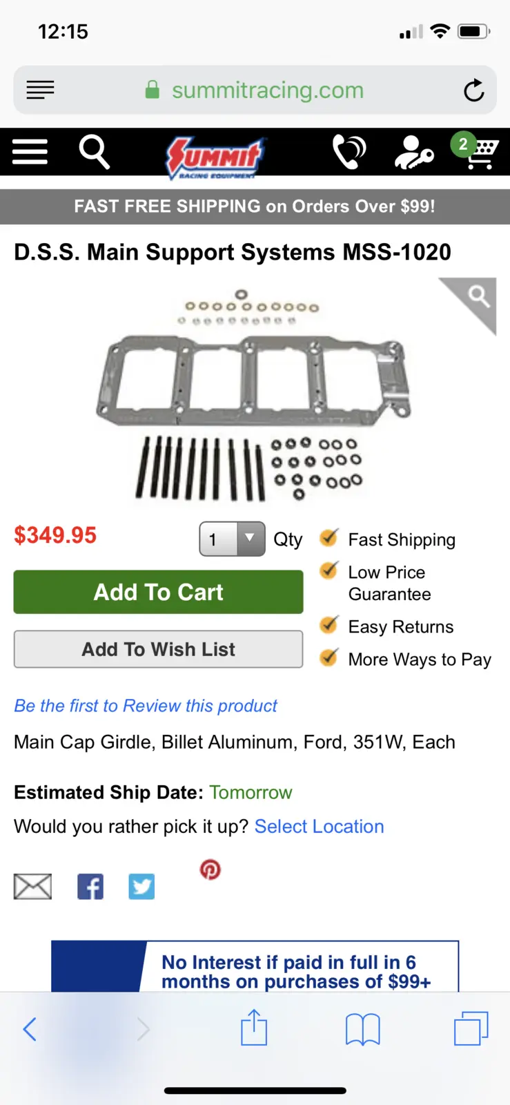

Been reading about 2 bolt and 4 bolts main. Anyone using this to Strengthen the bottom bottom, is it worth the $$
