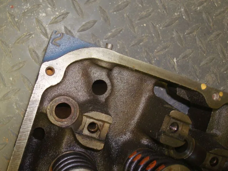

You said the engine has been modified to 4bbl. Clevelands had two styles of heads. 4bbl and 2bbl. If you have 2bbl heads and got 4bbl exhause gaskets, they won't fit. The heads are easily identified. They have a 2 or 4 cast in the corner by where the valve cover bolts on. There are 4bbl intakes available for 2bbl heads. So it sounds like you might have 4 bbl gaskets on a 2bbl head or the other way around.

How about posting a nice clear photo of the heads? Then we'd be sure. This is a 2V head. Notice the number is cast in, not stamped.

Thanks everyone, the problem is the look up out of date . I've had my parts guy for 25yrs. He had to go to the book to look up the correct listing. The computor only lists 351C or W not 2 or 4bbl. Also my VIN code is H so I also started wrong. I do have 4bbl heads. so I need to check block #'s to see what I have, or the prev. owner swapped heads or whole motor.
