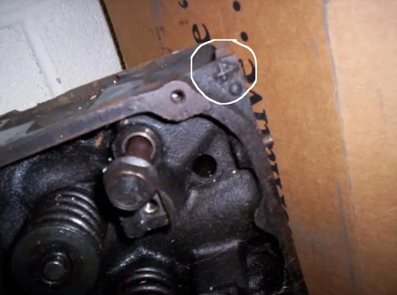

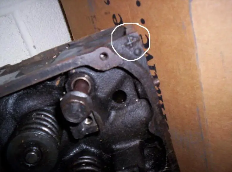

look on the left hand side of the head, in the top corner.....
