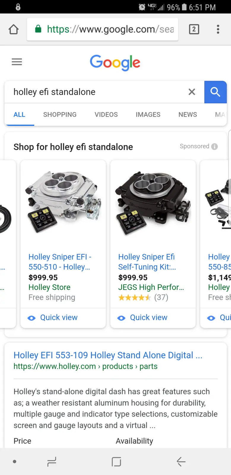

I ran a carburetor for years. It performed well but the driveability is so much nicer with efi. Everytime the temperature changes the carb will hasve to be adjusted. To convert to carb correctly will cost but not as much as converting to factory style efi.
Before i spent 600 on a carburetor I'd spend 1k on a stand alone efi system. This one supports up to 650hp.
Good info. Ill look into those Holley Efi’s. I know they’re popular so they’ve got to be a good choice.

Warning I have read many people having drivability issues with the sniper kits and large cams.
Hmm I think one of our members here may use this kit...
Reactions: 90sickfox
Steel1
Mustang Master
Aug 18, 2017
1,419
639
143
Connecticut
Apr 18, 2018
#32
  • Apr 18, 2018
  • #32
Yeah, I did some research on the the carb style efi kits and it seems to be a vacuum issue with large cams.
I read on the Fast forum if your not pulling greater than 10hg. at idle it can cause issues, also read something about their compatibility
with a stick..So before you go that route I would do some digging.
