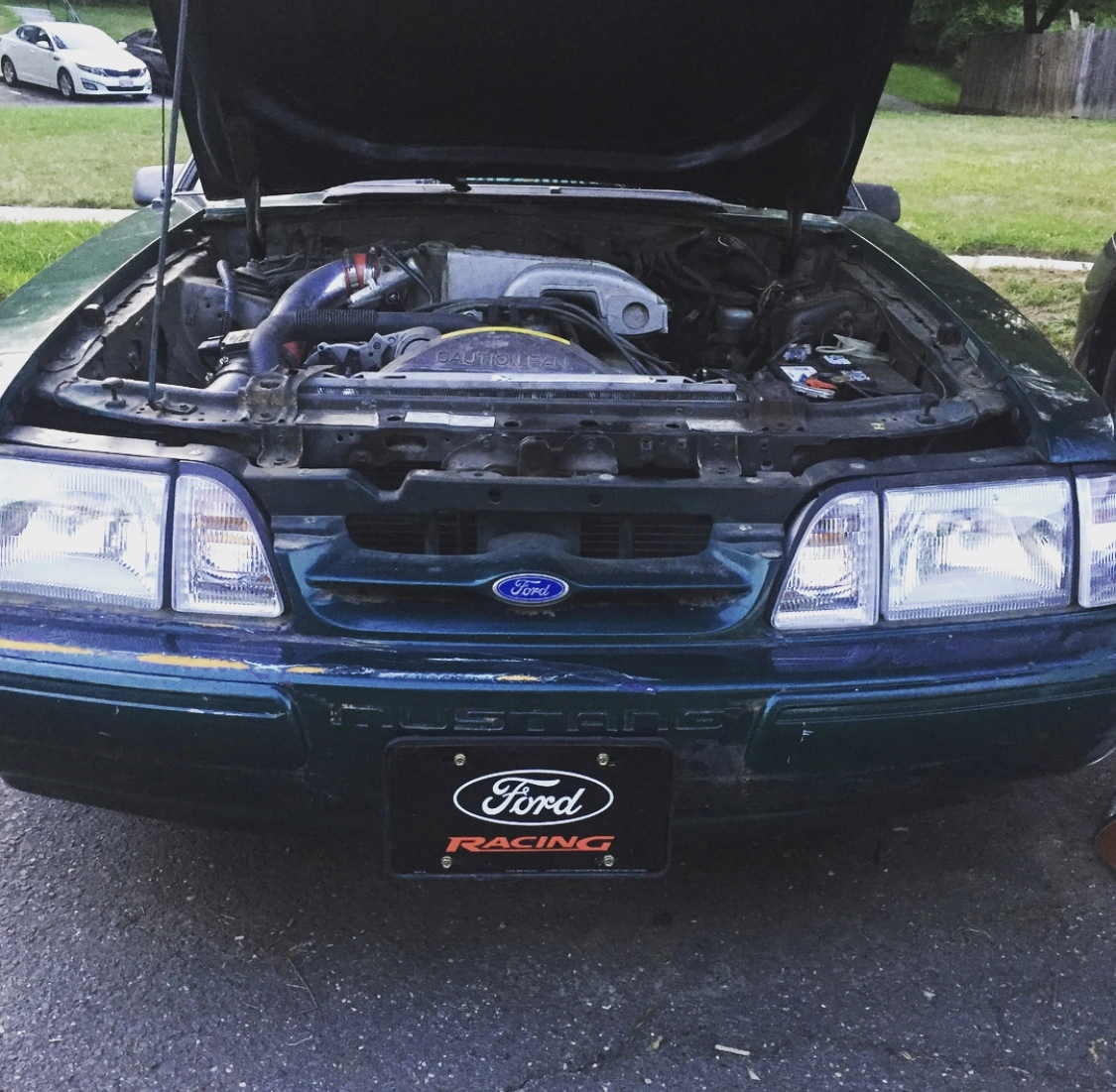

Im a auto tech. Just starting out on building cars. Had my 92 Hatch for over a year now and I want to swap the 351 windosr and stroke it to a 393ci. What are a good list of parts and brands i should use?
