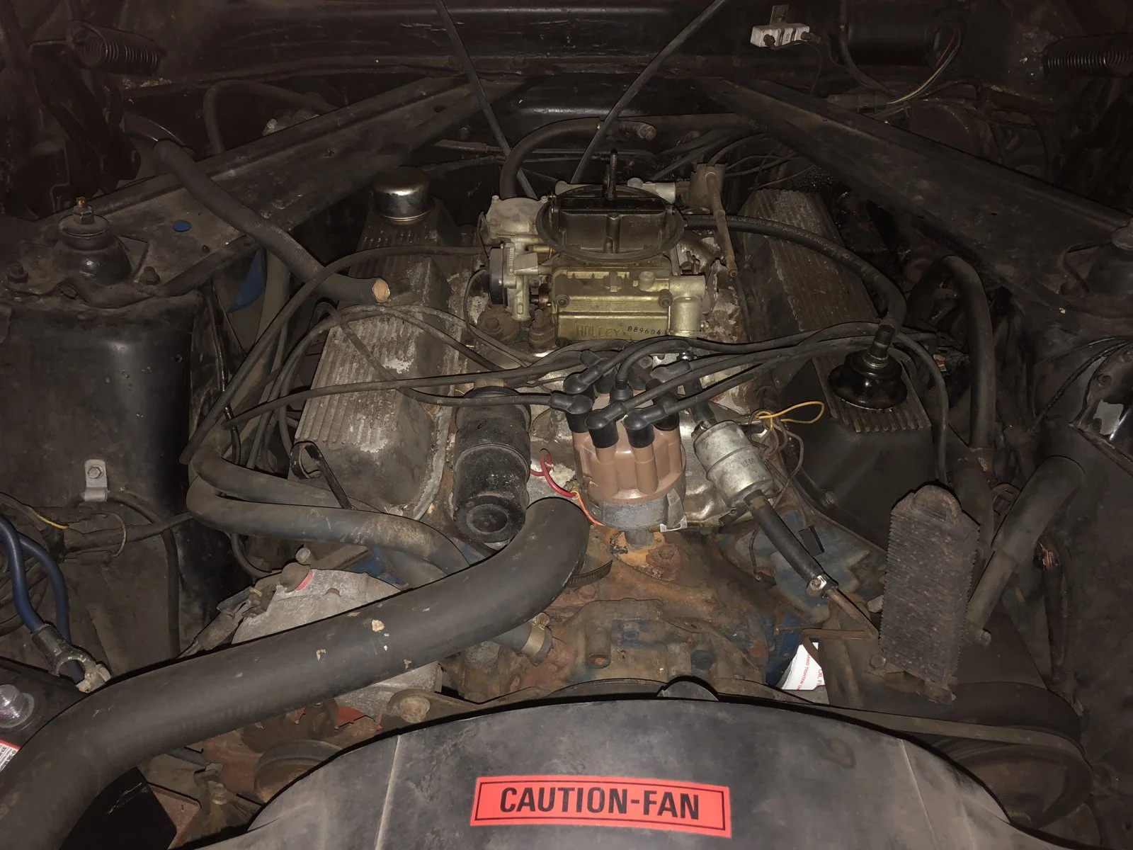

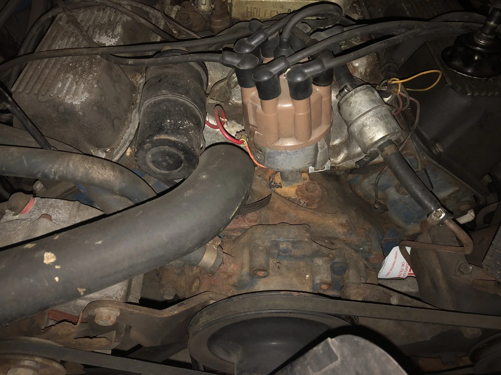

P partsguy9 New Member Jun 20, 2018 6 0 1 wisconsin Jun 20, 2018 #1 Jun 20, 2018 #1 Have a 73 Mach 1 with a motor trying to indentify 351m or 351c what do you guys think Last edited: Jun 20, 2018
horse sence 15 Year Member Nov 29, 1999 12,436 8,390 233 Wile Coyote's stunt double Jun 20, 2018 #2 Jun 20, 2018 #2 Need pics but if it is the original motor it is a 351 C

horse sence 15 Year Member Nov 29, 1999 12,436 8,390 233 Wile Coyote's stunt double Jun 20, 2018 #5 Jun 20, 2018 #5 Probably a 351c , because a 351 m has different motor mounts and it would set higher because it has a much longer stroke and taller deck height

P partsguy9 New Member Jun 20, 2018 6 0 1 wisconsin Jun 21, 2018 #7 Jun 21, 2018 #7 Any way to tell for sure?
horse sence 15 Year Member Nov 29, 1999 12,436 8,390 233 Wile Coyote's stunt double Jun 21, 2018 #8 Jun 21, 2018 #8 Look for a number on the heads ,block ,and intake . A 351 m is not a drop in motor like the 351 c so it is mor likley to be a 351c
