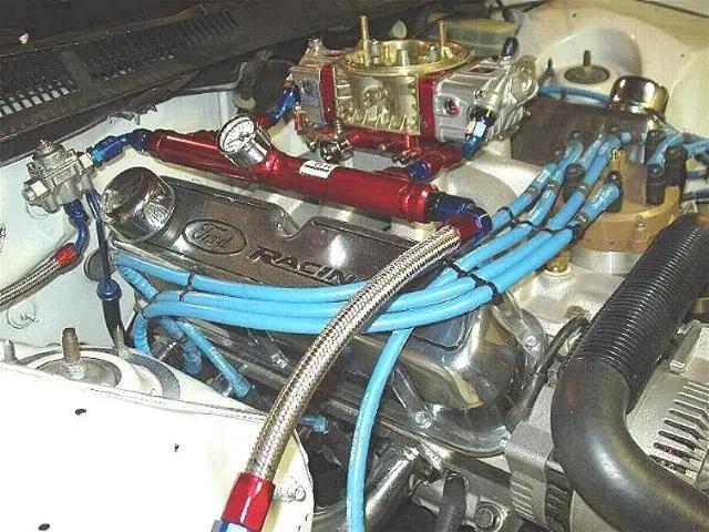

Not a Fox Stang, but I am just about done doing one in my 93 Tbird. Been a LONG SLOW project. Every thing that I looked at, seemed to need to be upgraded, and I ended up doing a lot more than I had planed. Just got my last order of fuel system parts and will start on the ignition next week. I went with a carbed 393 stroker.
