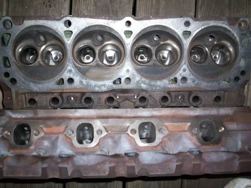

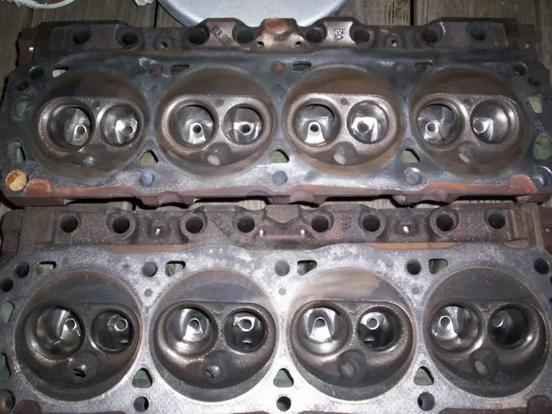

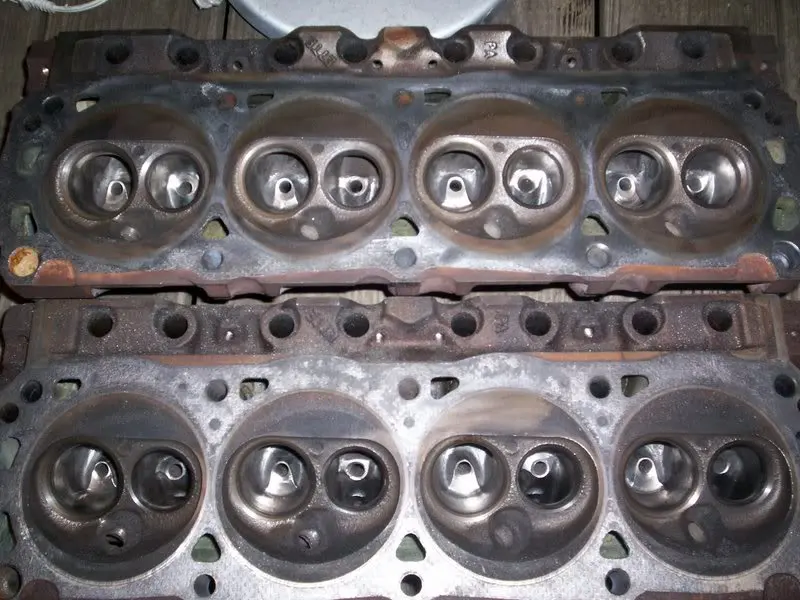

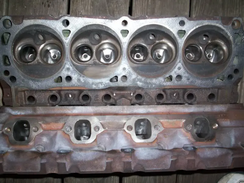

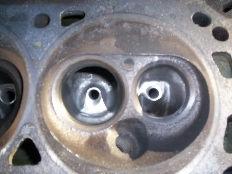

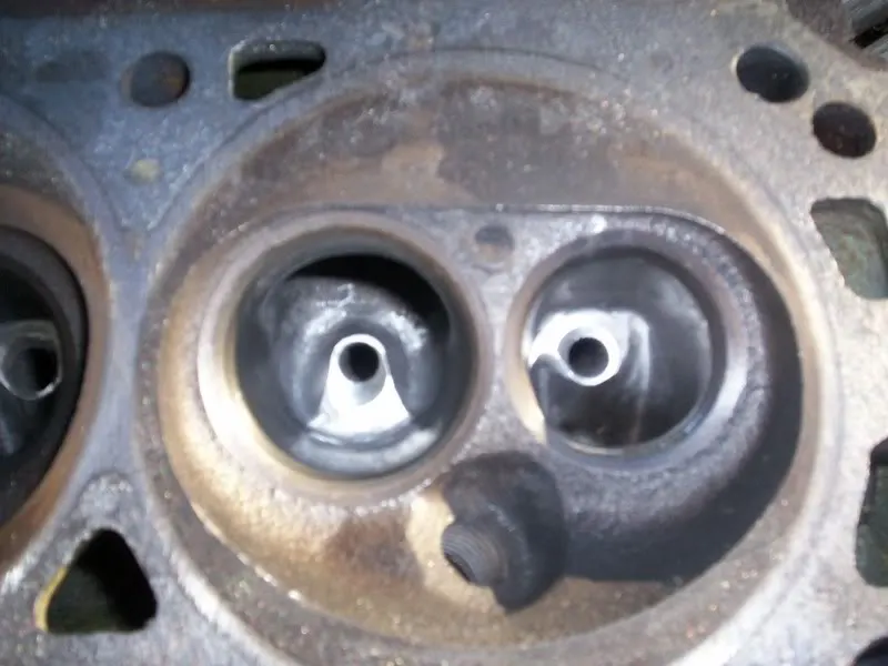

E7TE that came on 87 or later 5.0 stangs are your best bet. The D8OE combustion chamber volume is larger than the E7 heads and will drop your compression ratio. i ported my e7s and i have a set of D8OE heads sitting in the garage...
here are some pics of mine...
