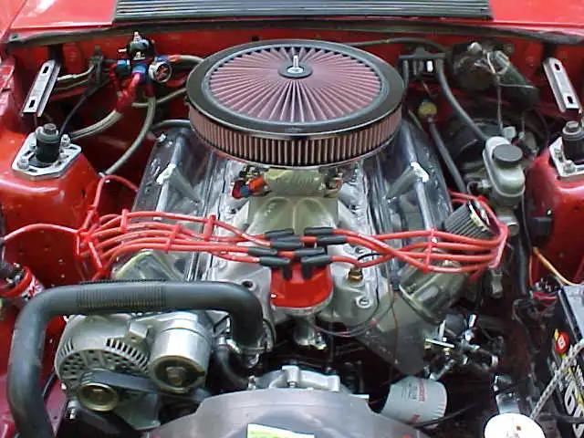

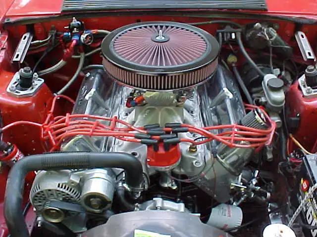

Here is my vanity swap :rolleyes:
Shakedown/shortshifted pass of [email protected], at 3300lbs.
Stroker parts are about the same money for the 302/351, why not stroke the 351? Mine made 581/539 flywheel#'s on pump gas with box stock parts and a hyrdro roller. Next combo will be a dart block with ported parts and make 650 on pump gas with a hydro roller. Just me though.
