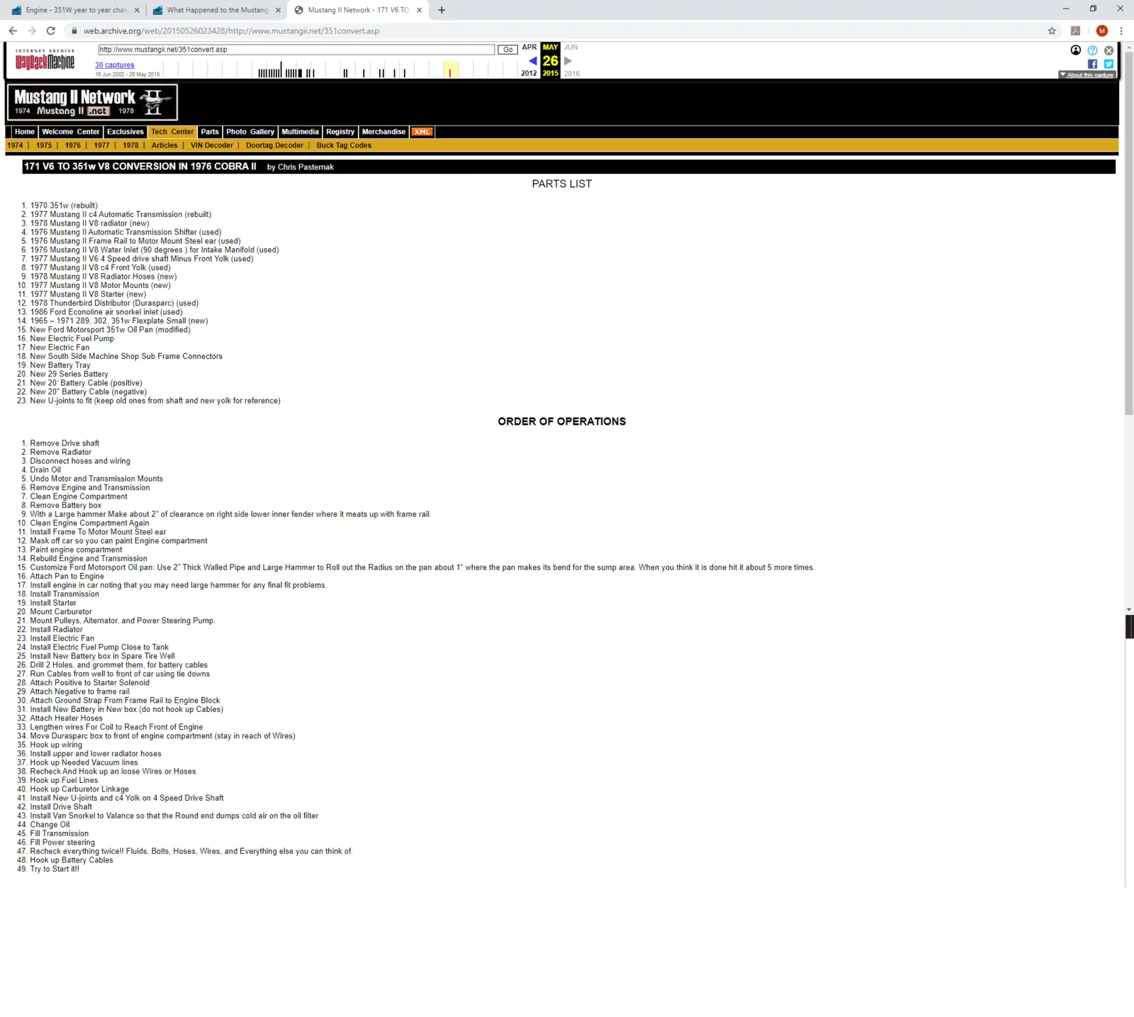

Blatantly stolen from MustangII.net using Wayback Machine:
