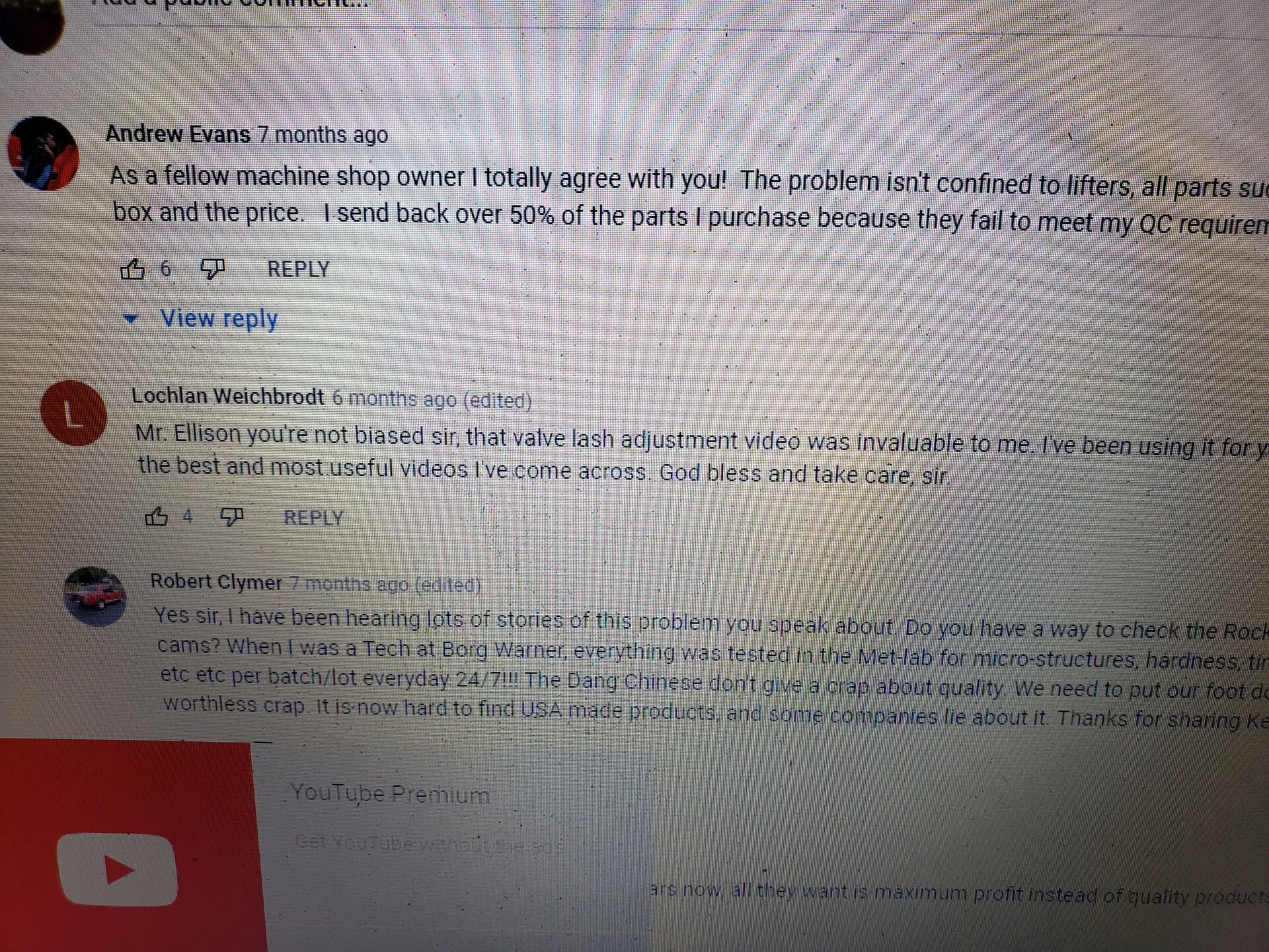

Ton of discussion about failed lifters and cams on a few other forums like Vintage Mustang and Ford Truck Enthusiasts
All just new stuff
Parts from Melling TRW Ford Chrysler and the like have all switched some manufacturing to China and will not disclose any of that easily

I just heard the same thing from a friend. He bought a new Siliverado "Redline" or wtf ever. It was a basic Silverado, and then they started mailing him the badges and decals as they came in. He had a lifter failure at under 5000 miles. From what I am trying to understand, the supply line was so messed up, that GM went to the company that makes the rear view mirrors, and asked if they could make the lifters and pushrods as well. It wasn't a displacement on demand problem, because due to the chip shortage, his truck didn't even come with the module that conrols the DOD. GM is going to service bulletin the truck when that computer is available.
I don't think this is going to be a major problem for the aftermarket. The cams and lifters made for the aftermarket from quality vendors are still produced domestically. I've actually watched the machine at Crane Cams cut a Ford lifter.
