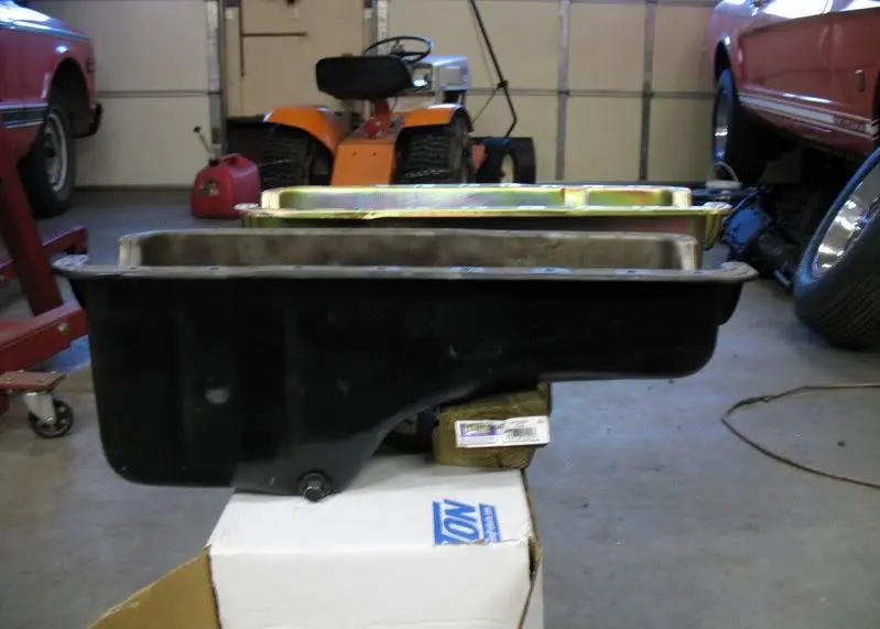

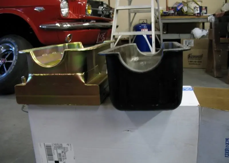

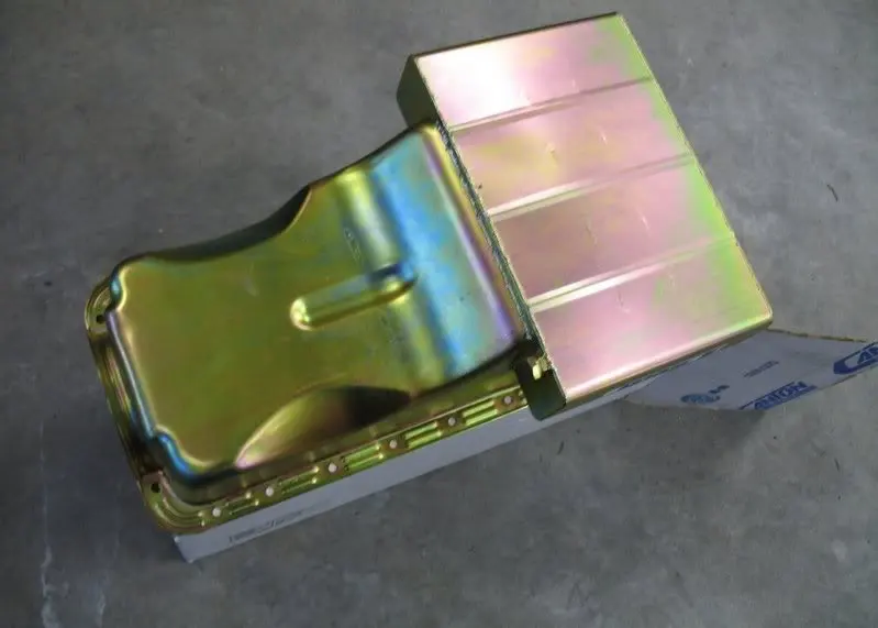

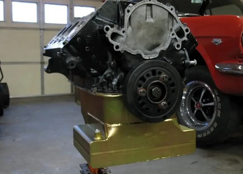

I am running one of the Canton 7qt T-Pan Oil Pans on my 408w. I also have a 25% of stock volume oil pump. This is all in my 65 coupe which is lowered about an inch and the motor is on the Ron Morris adjustable mounts which I think lower the motor a little too. I have never had any clearnace issues with the pan, even on speed bumps. That said you can see it showing just under the front roll pan. If you want some pictures I can snap some tonight. I say get something like the T-Pan, the large capacity is always good for piece of mind. especially if you are making the motor work!:nice:
Hi,
Similar experience here with my Canton 7qt. I checked its depth before installation and it was nearly the same depth as the stock 69' pan. My motor is also lowered, right down to the round frame cross member.
I am using the Milodon version of the same pan. It also doesn't sit any lower, and the dipstick through the timing cover still works.
