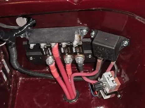

Here is my power distribution point where the battery used to be.

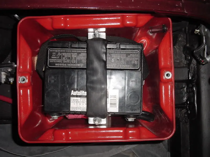

What did you use as a ground for your battery?
The ground cable is contained inside my battery box in the trunk. it is 1/0 marine battery cable. The lug is double nutted at the bottom where the stud goes through the trunk floor at the frame flange.

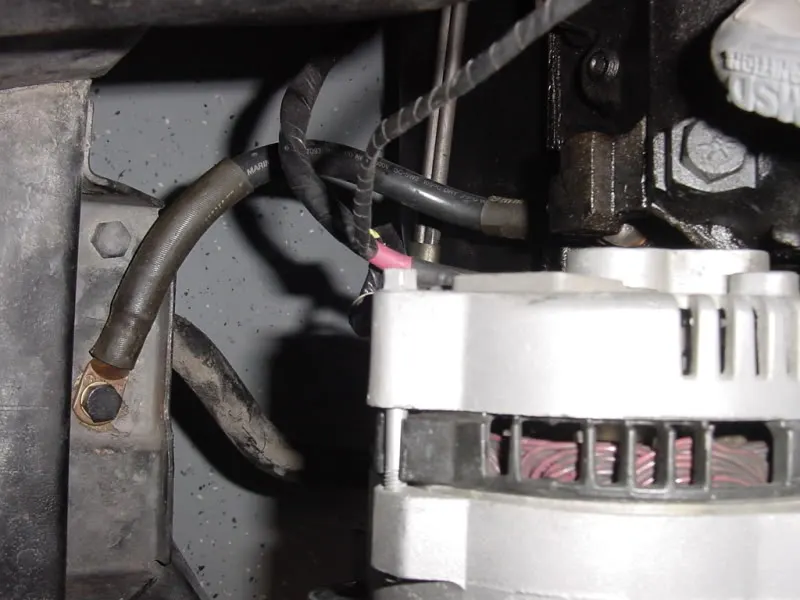

The Engine is grounded with the same type of cable to one of the sway bar bolts and the other end to the side of the block just below the alternator:
Just make sure all lugs are crimped good, the paint is scraped off to bare metal and connections are tight.
