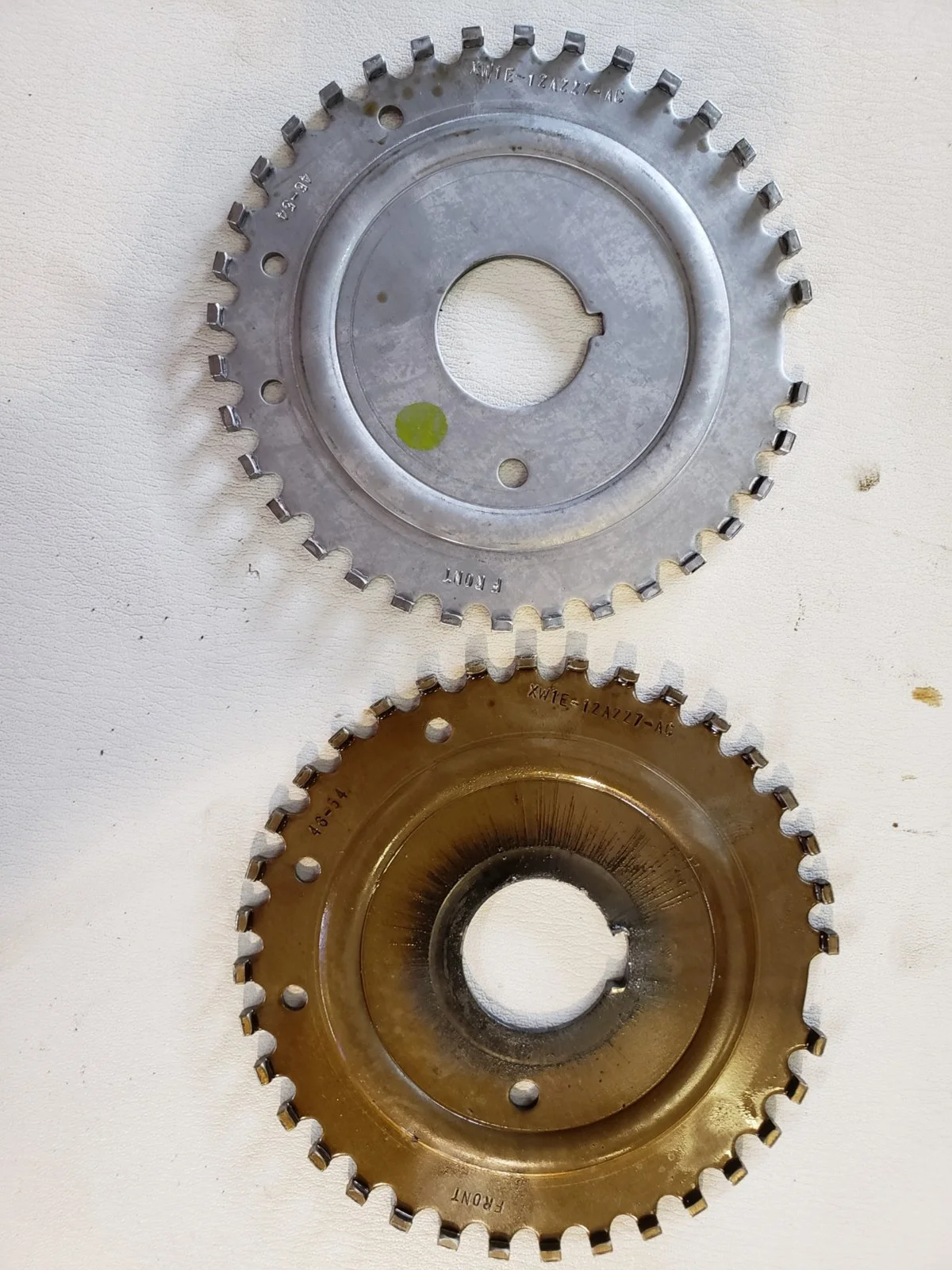

Well found the culprit. I stethoscoped it a while ago and noticed the sound was coming from the center front. After the front end got dug into, the crank sensor sprocket’s keyway was found whored out. Don’t know how this happened but Im having the whole timing set and oil pump replaced (why not since it’s opened) for good measure.
If anyone runs into a similar issue you may have this problem. I hope
this post and video helps anyone out if they find themselves scratching their head like I was before I finally got the chance to have it taken care of.

Man! That sure allows for a bigger timing variance than you would want! Great find!
