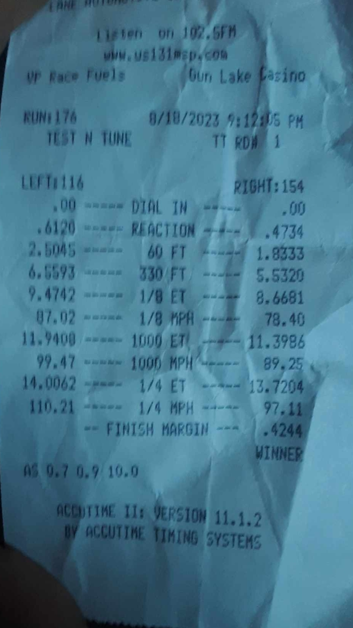

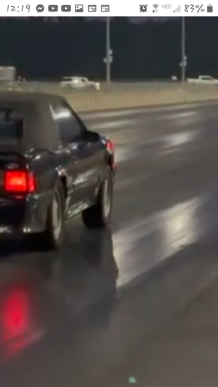

I know this is aold thread but I've been looking to compare times since I ran friday night. I ran a 13.72 in the 1/4 in a 87 gt vert speed density with explorer intake 70mm tb and gt40ps through a aod with pa street/strip vb and transgo hi rev governer and 4.10 gears with a 1.83 60'. Full interior car. I was very pleased with the run.
Nice man!!! Tweak tweak tweak, and you’re in the 12’s!!!
(Why I got notified of this thread from 2005, I have no idea…… but keep us posted of your progress) :cheers:
