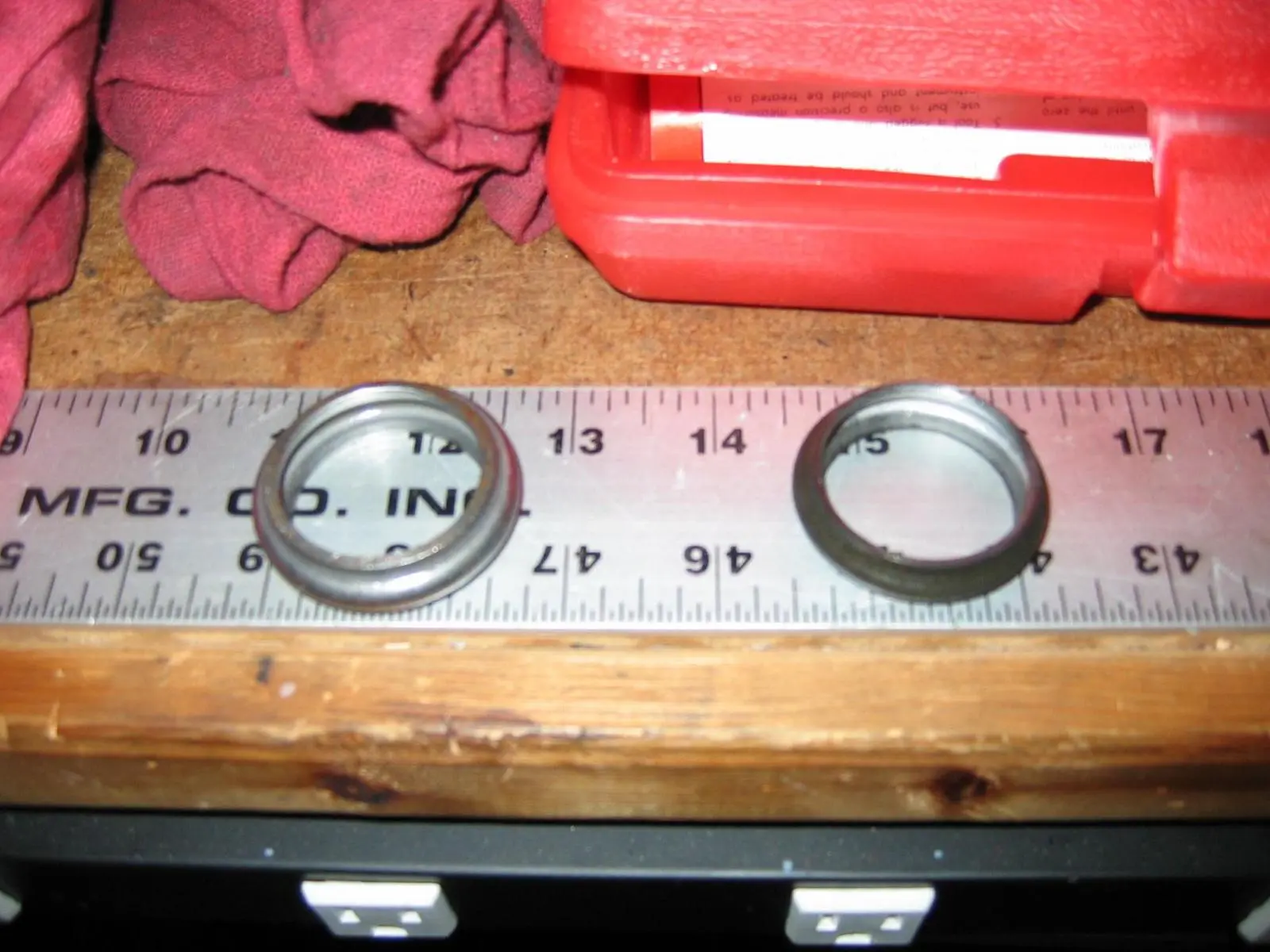

what is a new crush sleeve supposed to look like? i finally got time to pull the pinion and i crush sleeve i used(the one that came with the gears) looks just like it did before i put it in, but it also looks just like the original one i pulled out. the reason im wondering is because i have another crush sleeve that came with a mini install kit i have and it looks different.
the one on the left came with the gears and the one on the right is the original one. the one on the left is also bigger than the one on the right.

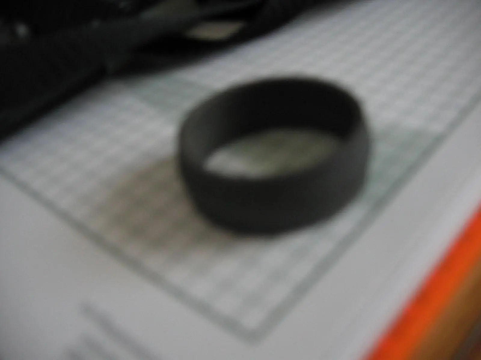

the other pic is of the one that came with the mini install kit

For what it is worth, the purpose of the crush sleeve is to apply a constant pre-loading pressure to the bearings. It does this by deforming along is short axis (height). The metal is soft and easily deformed (hence the name).
The pre-loading forces are not very high (measured in inch-pounds).
From the pictures, the diameter can be seen. It is difficult to tell the thickness of the two sleeves. However, as best as I can tell from the pictures the sleeves are the same height. If true, both are in the same state (crushed or not).

kk thx, i just measured the one on the left(the one i was using) and it measured .508 and the one on the right(original) was .440.
