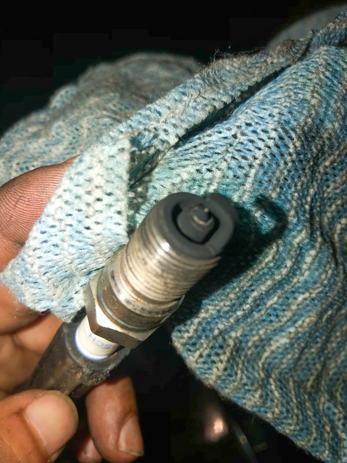

Had a terrible weekend gentlemen.. alternator took a dump on me, turbo oil feed line somehow came off the filter and literally pumped all the oil out whilst on the road, luckily I was just about to pull into the parking lot, so I didn’t run it very long like that. Lastly, I checked one of the spark plugs and they do not look good!
Sorry to hear about your weekend. I know how that goes as I usually have the same kind of luck!
Did the electrode end of that spark plug feel greasy at all? From the pic, it looks like that is just some carbon buildup from running rich and/or slight oil intrusion into the cylinder. From the amount of oil you described coming out of the exhaust, I would expect those plugs to be caked in oil if it was coming from the cylinder. I'd pull the remaining plugs and see if they are consistent.
Another way to check would be to pull the turbo and check the inside condition of the header pipes compared to the downpipe. That would be a good opportunity to see if you have a restrictor on the feed line and the condition of the drain line. I'm still leaning toward a turbo seal issue....
