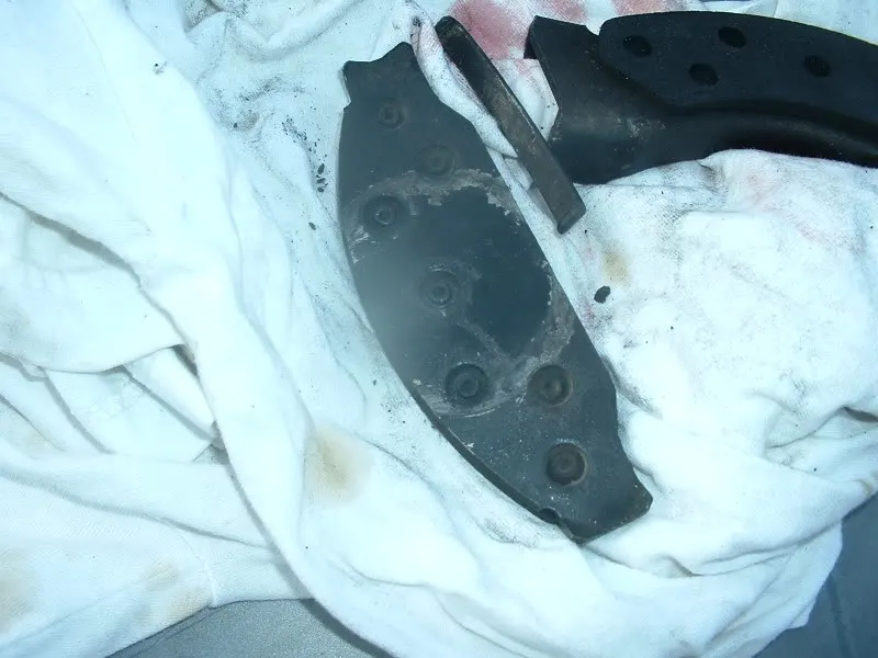

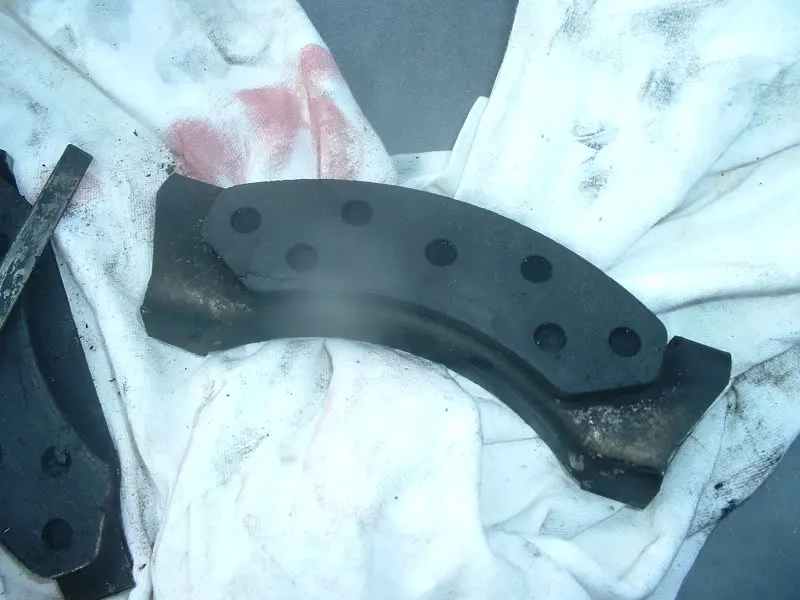

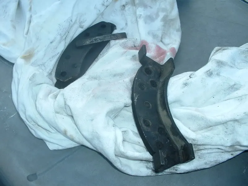

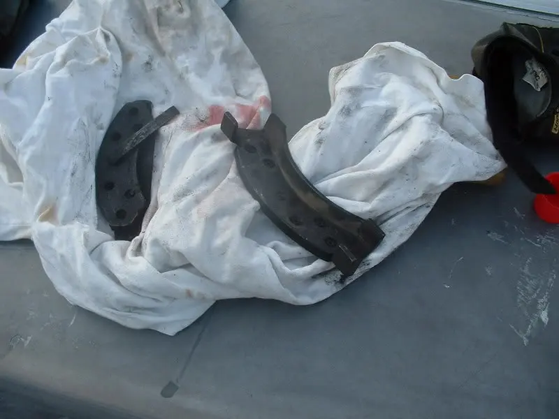

my neighbor bought a 65 mustang inline 6. he wats to change the pads in the front and it has 4 lug discs in the front. problem is we have no idea what car this setup came so we can ge the pads. i have some pics of the pads, any of u guys know what they are????
ill post pics of the set up when i can. im a go to the auto parts store , and check out pinto/mustang 2 pads and granada pads to see which ones match up. thanks :nice:
You are not likely to find either in stock at the parts store, but you can see pictures at at advanced auto parts web site or below from their site.
D90 Pinto/Mustang II http://www.partsamerica.com/product_images/img/ray/pgd90m-1.jpg
D91 Granada http://www.partsamerica.com/product_images/img/ray/pgd91m-1.jpg
