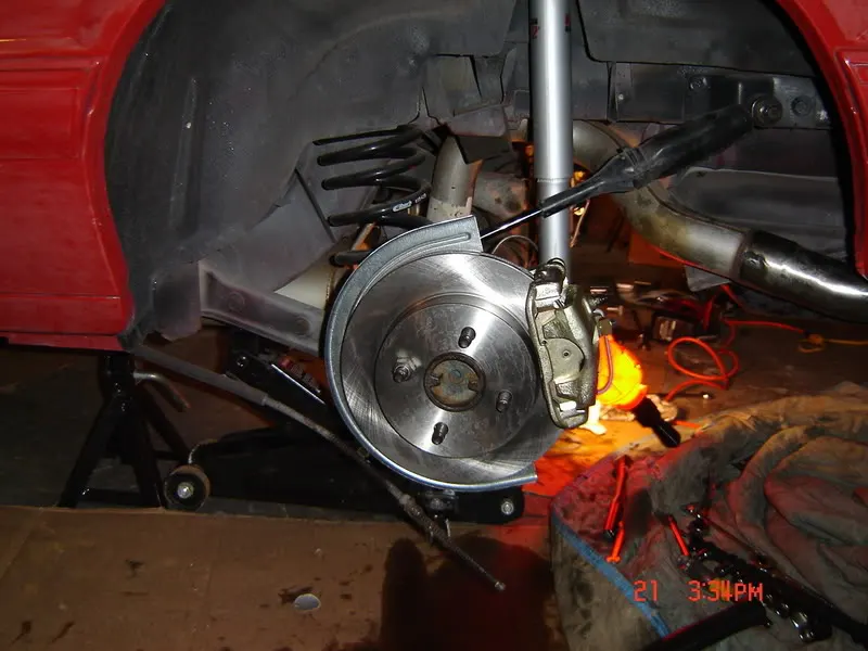

4 lug rear disc pic request
here ya go its the ssbc kit but its the same as the turbo coupe and cobra stuff. phil
Not QUITE teh same as the turbo coupe + cobra stuff with regards to the axle length. The SSBC kit allows you to run your stock axles and retain the stock track width. Id post up pics of my Rear SSBC kit, but its sitting in a box in my bedroom:D , winter project not quite under way yet.

Flav,
I think in order to make the call on which to keep, you have to know which wheel you will want to run. I believe this is the most importent aspect. Big brakes can be had for 4 lug, they are just more expensive or you could go the custom route.
Do you want 5 lug wheels? If it were me and I liked my current 4 lug wheel, I would just use what you have.
On a side note, I do not know which width wheel you have in the rear, but if you plan to run the T-Bird rear axle length, Things may get tricky with backspace/offset. You could always get the North Cobra brackets for the T-Bird brakes. They allow you to run the Fox length axle and still use the T-Bird calipers.
Just an FYI. :D
im running a tc rear and thought i'd have much more clearance issues then i really do. they are a bit wider however give the car a better stance imo. it made my 245's look like 275 lol, so yeah, but do you know all you have to do to make that work. im pretty sure you have to go with a different master cylinder. and if you do want to go 5 lug but keep the t/c rear, then go to discbrakes are us, they offer a re-drilled rotor for the tc rear that will fit 4 and 5 lug. it might be worth looking into.
THE PONY BOY:
How much of a braking difference did installing the kit make? are you still running the stock calipers up front or did you upgrade to the 73mm units?
I'm not trying to speak for PONY BOY, but i installed my brakes in two steps. The first was to convert the rear to '94-'04 Cobra brakes: 11.65" rotor, Varga caliper, 5 lug on a Fox length axle. I did all of the neccesary mods: M/C, Willwood prop valve, gutted the stock proportioning valve and replaced the valve cap with a solid unit. I did not notice a big difference in the stopping power. It was slightly better than the rear drums. What I did notice was that the stop was much smoother and more controlled feeling. The fade was not there any longer.
Now, when I added the 13" Cobra fronts with '95 spindles and PBR 2 piston calipers up front, the difference was night and day. Stops are much shorter.
Basically, you will not increase the stopping power with just a rear disc conversion. I can back this statment with a call that I made to Baer when I was expecting more from my rear disc swap. The sales rep told me that the real benefit is in the fade resistance the rear disc offers.
Think of it as a nice upgrade in looks and the start of a good foundation for further braking improvements.

I plan on running my 17x9 cobra r wheels, if i go to a five lug i would like to use the 10th annaversary wheels. I am buying a house so i figured since i can get a good deal on this i might as well go for it, ina few years when i get bored i will change to 5 lug.
I think the TC axle is only .75" wider right? I should be ok
I can get you some pics tomorrow if you want, I have the turbo coupe rear end but with 16" pony wheels. Let me know if you want me to post it up...I honestly haven't payed attention to see how much of the rotor or caliper you can see through it, cuz the spokes are pretty beefy on those wheels.
