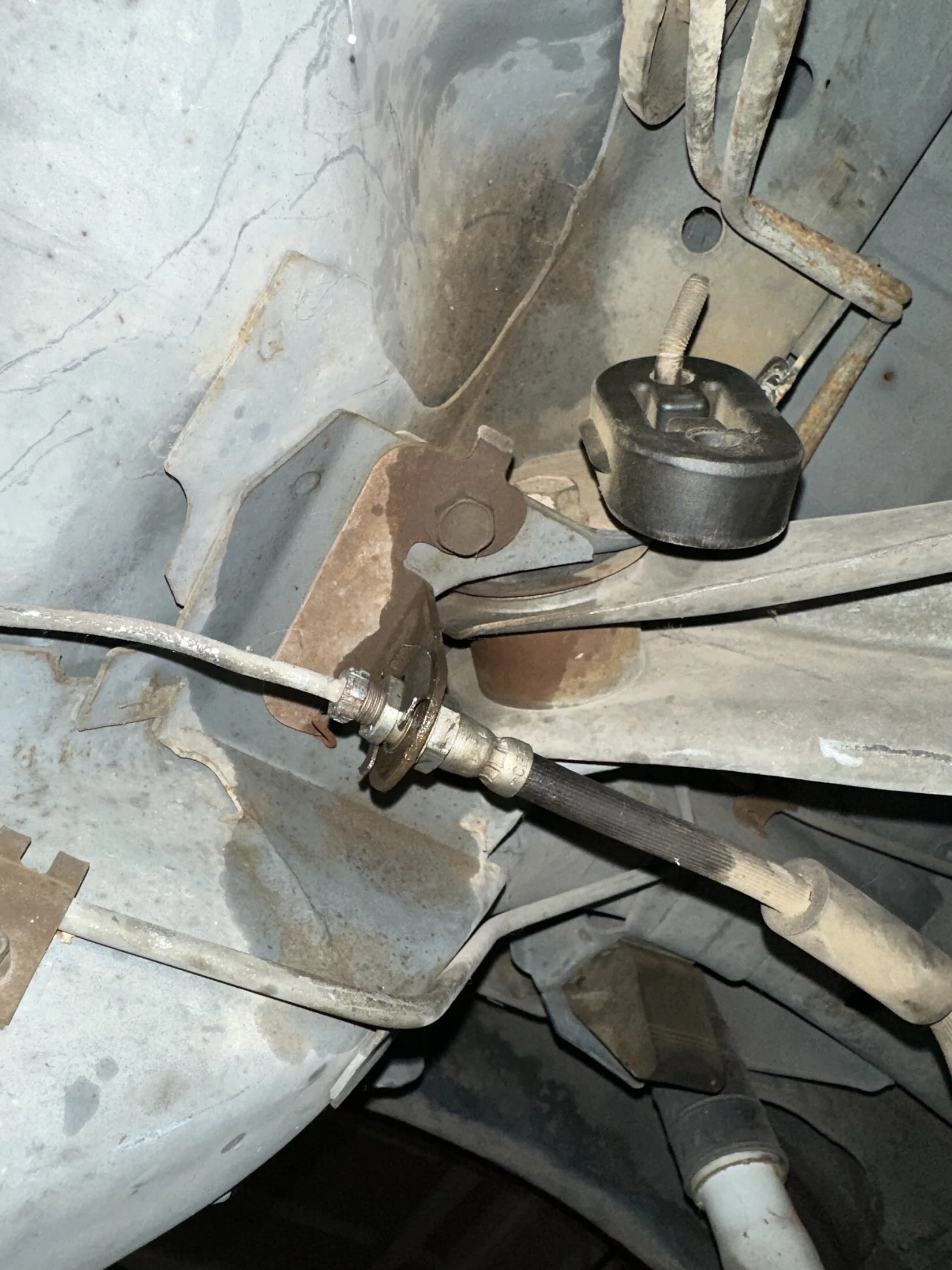

Little update. My brake line (rubber hose) from drum brake set up on the 93 rear end doesn’t look like it connects to the 89 (disk break) setup. Looks like two different threads. Anyone know if there’s a work around.
93 drum break rear end is out and 89 is hanging by the upper control arms. Looks like I may have to leave the disk breaks with the car.

Your first pic is for single exhaust or 86 and older cars.....
Damn ok. Is there an adapter that would work for this conversion and the other way around. Crazy that the 8.8 rear end w disk breaks bolted right up to it. Unless I bought the adapter a long time ago. Much appreciated though. The car is an 89 4 cyl conversion in the 1st pic.
I just went through this converting my 83 to take dual exhaust.....
You will probably have to change out the brake lines...
Look at LMR's site... I think they have the kit for the body brake line and the housing....

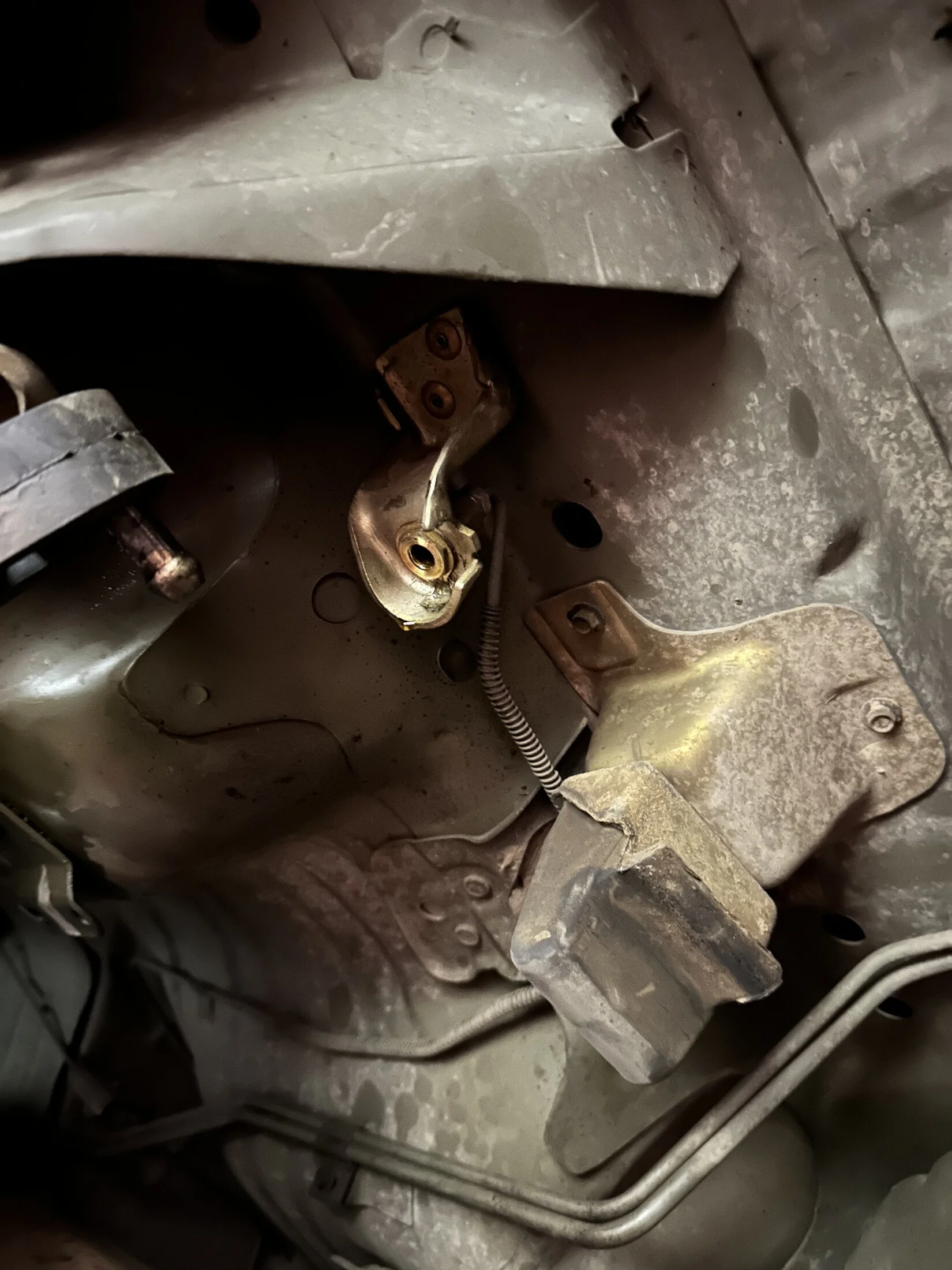

So your second pic is the car you want to install the rear end into?
All you should have to do is install new lines on the rear end housing then... I think LMR has them for drum and disc brakes...
Cur the end off the 93 line and use fittings amd a union to merge the lines. A good flaring tool will do this easily. Just need 2 fitting and a union block.
