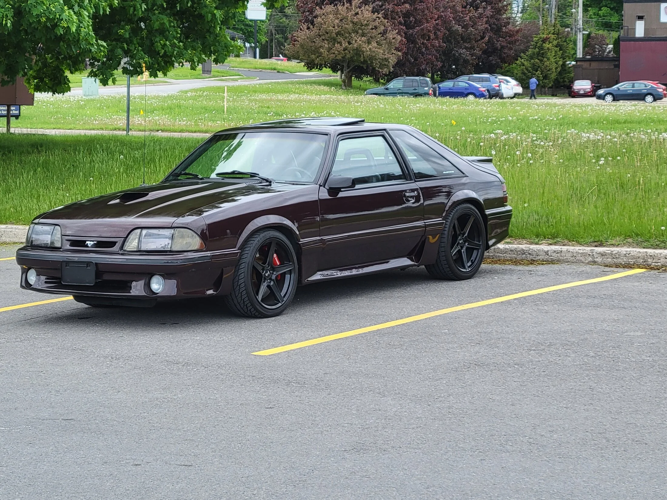

I have a Saleen Reps, 18x9 with a 24mm offset all around. Fronts are 255/35/18, rears are 275/35/18 (I will likely put a 285 or 295 on these rims next time).
I have stock foxbody front control arms moved inward 1/2" with 96+ spindles and XTS calipers and 14" front rotors and LS rear calipers on a 11.81 rear rotor. I have fox length axles. I did roll my rear fender lips. I have no rubbing front or rear.

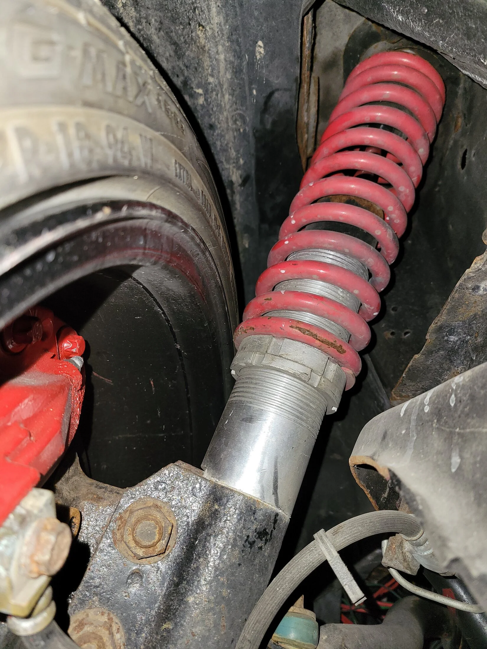

I needed a 8mm spacer to prevent the rim from hitting my coil-overs (without the coil overs I don't think I would need spacers). I put the same 8mm spacers on the rear as well because it looked better and I had the room.
This is my clearance with the spacer.

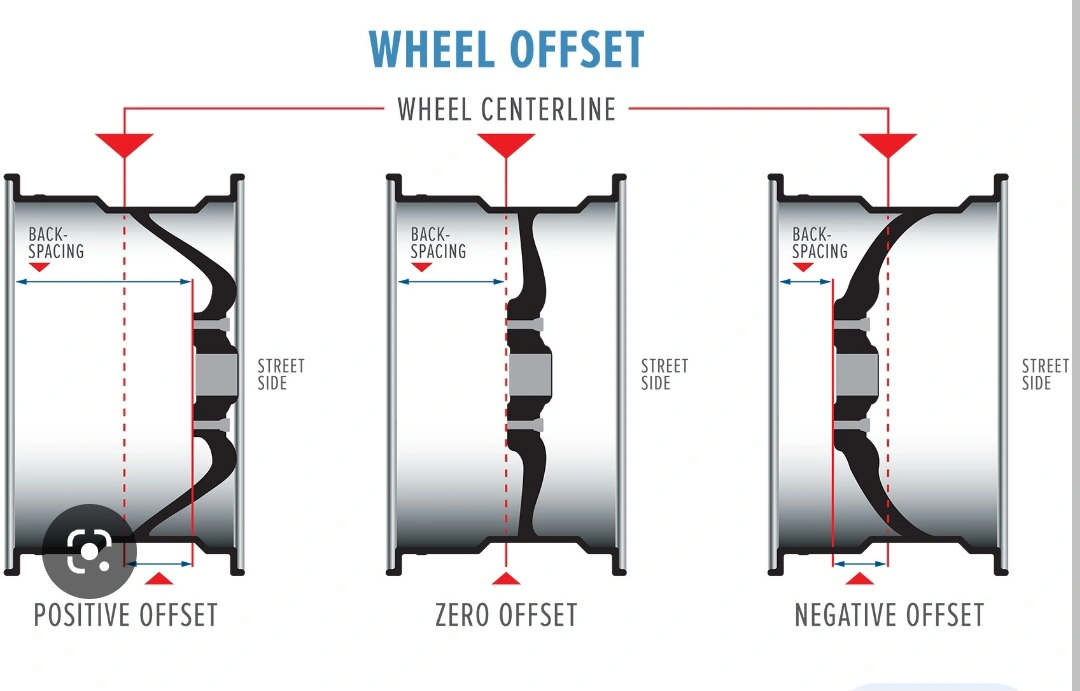

If they are aftermarket wheels there should be numbers on the backside of the spokes. Usually, you can find the offset there. The rim size and width will be 18 x 10 the backspacing will be et ??
If there aren't any numbers you can lay something straight across the back of the rim and measure down to the center of the rim where the wheel meets the rotor. The measurement we'd need from there will be in inches.
Backspacing or offset is needed for us to tell you if the wheels will actually fit.
The wheels on the front of my car are 50mm offset with a 13mm hub centric and a 8mm spacer. That makes my front offset 29mm. My wheels are 18 x 8.5. If I used an adapter it would be 1 inch thick ( roughly 26mm ). That would make my 50mm wheel 24mm offset pushing it out an additional 5mm. more than my current set up. Offset or backspacing are the most important numbers to know about your wheels. That's how we can tell how far inside or outside the wheel will sit in the wheel well.
