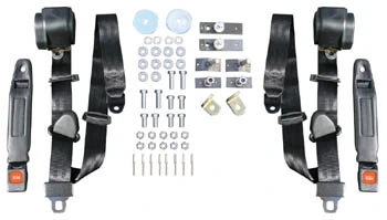

I've been thinking about these with my recaros.
4 Point Installation Instructions
I'm not saying they are anywhere near as safe as a cage and restrain system done proper, but they look better than nothing at all. I don't like the 3 point belt kits for convertibles because they atttach a lot lower than your shoulder which can compress your spine. And I'm not putting a roll bar/cage in my daily driver.
