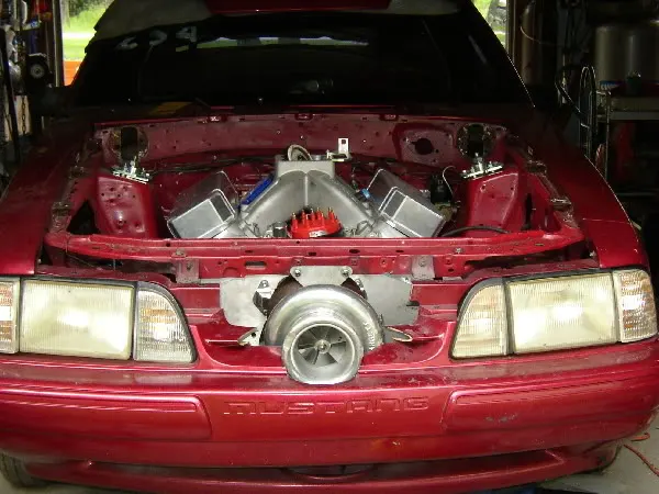

the rear end will hold up but u need to up grade parts. the gt has heavier springs than a lx. it will be easier to do if u have a k member where u can change the springs. there are sites that have bbf in mustangs. every thing is bigger so hard to get it all in the car. here is my bbf so u can see how big they are. a tube k member would be best to get more room for headers. i think u have to go to manual brakes to have room to mines a full race car so it does not matter to me
