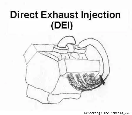

Have you considered DEI? :shrug:
That may be a viable option. For those scratching their heads, here it is:
The simplicity of it is sheer genius!
