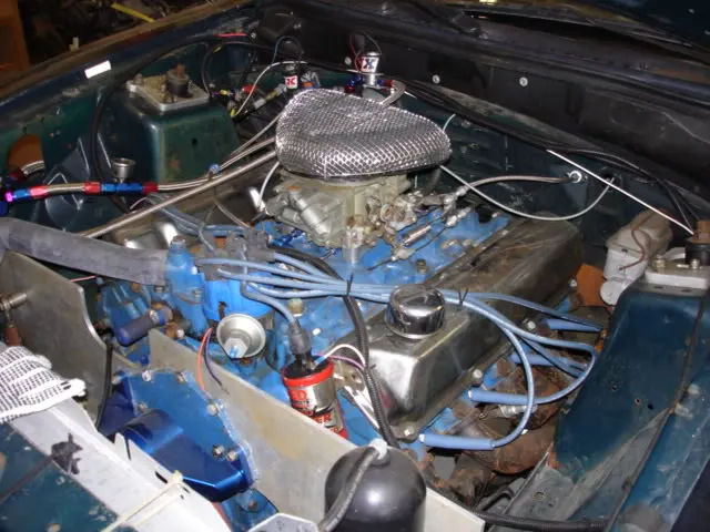

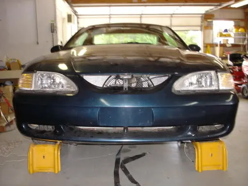

I guess I'll bring this old thread back to life. For those who say that the big 460 won't fit under the stock hood....
:eek:

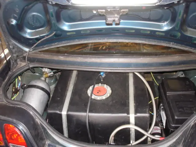

I bought this recently off of ebay (when will I learn to stay away from there? LOL!!). The previous owner had done all of this. It fits under the stock hood with the blanket removed. I don't like that type of air filter, but it lets it fit under the hood quite well. I don't know how it runs yet, but I'll be getting it the rest of the way done soon and let you all know how it goes. It's a 460 with a c6 and a pretty healthy fuel system to run the 750 cfm carb and nitrous system. I'll get the thing running and to the strip before I attempt to finish the N2O setup. The p.o. said it should add about 200 hp or so pretty easily. It would be/should be street legal, but I probably won't worry about that for awhile anyway. I think it was Bill Murray on the movie "Stripes" that said "This looks like it might be fun" :banana:
:eek:
:nice: I've always liked the 429/460, used to have one in a 76 T-bird.
Though I must ask, why do the plugs look easier to change than my 5.0L :bang:
