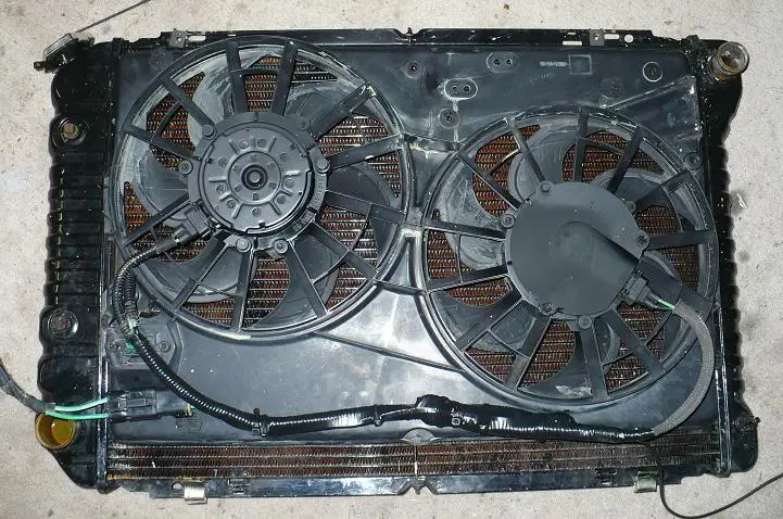

Sorry if this is a repeat question, but I am new to this. I bought a unfinished 1990 convertiable with a 460/C6. i drove it for the first time the other day and you could of fried a eggs and bacon on the motor it got so hot. It has a aluminum radiator and high flow alum water pump, electric fan. I know the fan is to small and it does not have a shround. I'm sure there is some one out there that has fixed this problem. Ive looked at several fans but did not want to buy one that does not pull enough CFM. Can any one recommend a fan that is not $500 that will work. Thanks for your help!!

Ford Contour/ Mercury Mystique V6 fan. It fits nice and pulls a lot of air. I forgot to mention it was $30 at the junk yard.

take some measurements of the radiator and head over to the pick a part or junk yard.
there are tons of nice fans w/ shrouds for 40 bux. 2001 stratos fans work well taurus fans you name it

Thanks for all the info. I have tried the junk yard but cant find a fan that fits. My radiator measures 26" W x 17" H. I found a fan on ebay but its a no name china fan, I'm kinda scared of it. Just trying to get some info on what others have done. One more thing, is there a preffered thermostat> I have ran a 160 to 190 and cant tell a difference. WLDHRSE, it was will driving. Keep the suggestions coming. Thanks!!!
87GT DROP TOP, do you know the size of the fans you have in the pic?

Jun 14, 2010
  • Jun 14, 2010
The whole assembly or just each fan?

The whole assembly. Thank you!!
