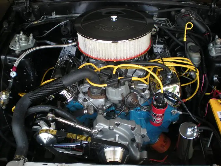

I've tried 3 times to post some pics and cant get them to work. I tried down loading them into photo bucket like the other guy said and it still didnt work. I would love to get some on here if I could just figure out how to do it.
Email them to me I will post them for you.

I just sent them. Thanks!

460 STANG said:
I just sent them again to the address you showed.
I just got both at the same time. The picture of the car you sent was really small.
Here are 460 STANG's pictures.

Very nice!

Thanks!!!! I just dropped off at the muffler shop. Its got 3 inch exhaust that dumped at the rear end, man was that thing loud, got to have some tail pipes. Thanks again guys I really appreciate it!

looks great! glad you got the issue worked out.
