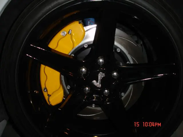

I haven't been on here much because I just moved to the coast but in the last week I had my wheels powdercoated black. I don't have a better pic and won't be taking any that soon but here's the only one I have that I sent to the shop that did the wheels
