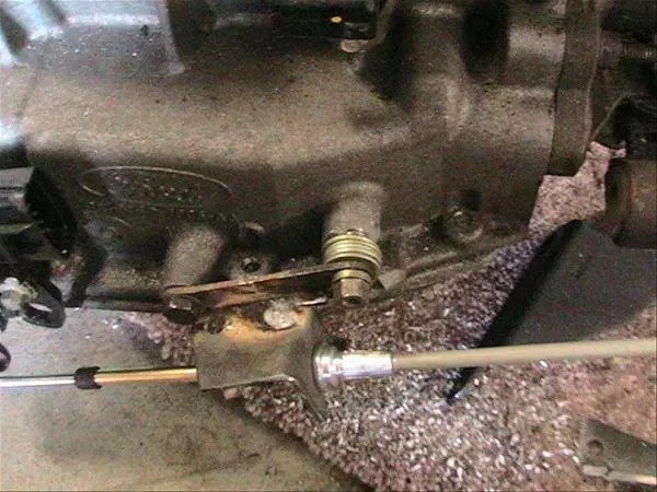

Here are the beginning pics of the conversion.

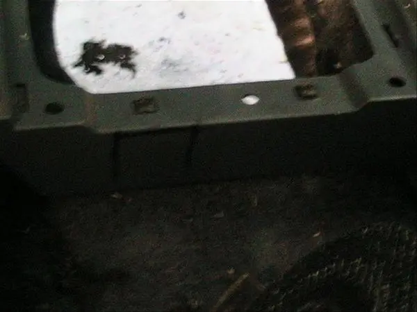

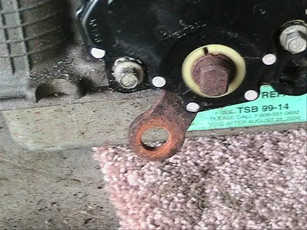

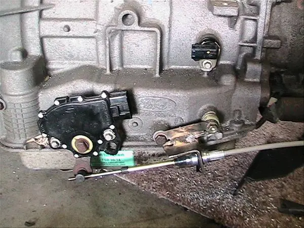

Before I started, I realized that not only was I missing the shifter cable bracket that mounts on the tranny...but one of the mounting pads had been cut off on an angle...WTF! I won't complain too much as I got a killer deal on the entire setup. After contacting the Ford stealership I found a new bracket for $20...the only problem is I wouldn't be able to get it until Monday after the holiday. I then contacted the local salvage yard....and they wanted $25!!! :eeek: I gave them a heads up on what the stealership wanted for it...and the wouldn't budge a single dime!!! I honestly hate this place is a passion....but unfortunately it's the only one within 25 miles. :curses:
Anywho, I decided to fabricate my own with the brackets that came with the Hurst shifter kit. Most of you doing this shouldn't have to worry...especially those just interested in doing the quarter stick shifter mod.
Here is the fabricated bracket. You can clearly see the mounting pad is hacked off, and I re-drilled the hole and added a heli-coil and some washers.

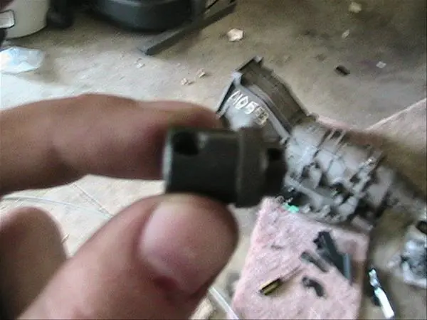

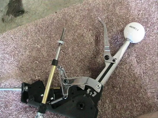

Next issue is the quarter stick shift cable. The end that mounts up to the tranny is a little ferrule that is supposed to go into the little shift arm.
The problem is, the stock 4r70w configuration has a shaft with a nut.
What I ended up doing was cutting the plastic bushing in the shift arm allowing me to tap out the shaft & nut. I then slid what was left of the bushing over the ferrule and slid the whole thing into the shift arm.
Here is what was left...
Here is the ferrule with the bushing...
And here is the end result...
The detents on the Hurst c4 shifter seem to match up perfectly with the 4r70w.

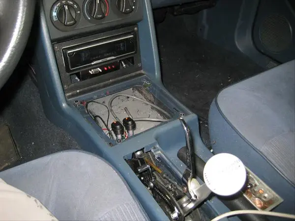

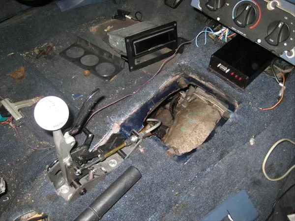

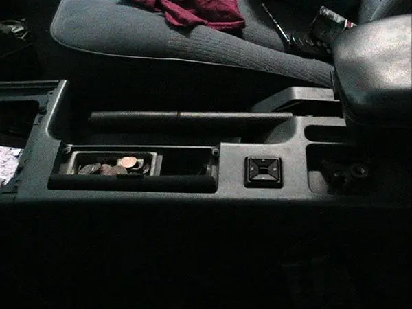

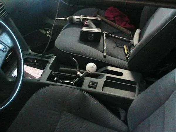

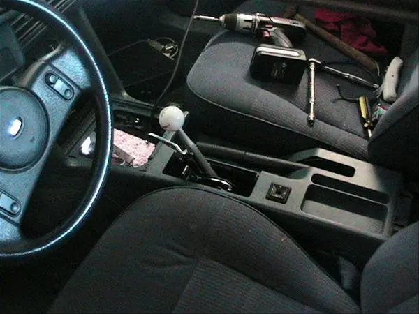

Next up, mounting of the quarter stick shifter.
Because this car is going to go the way of the do-do I decided to go ahead and mount the quarter stick where the ashtray resides.

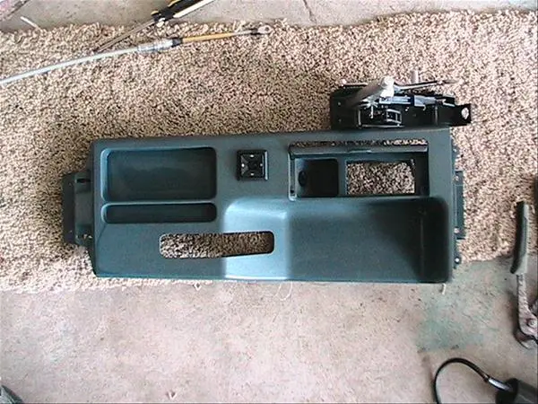

All of the ashtray garbage has to get hacked out.

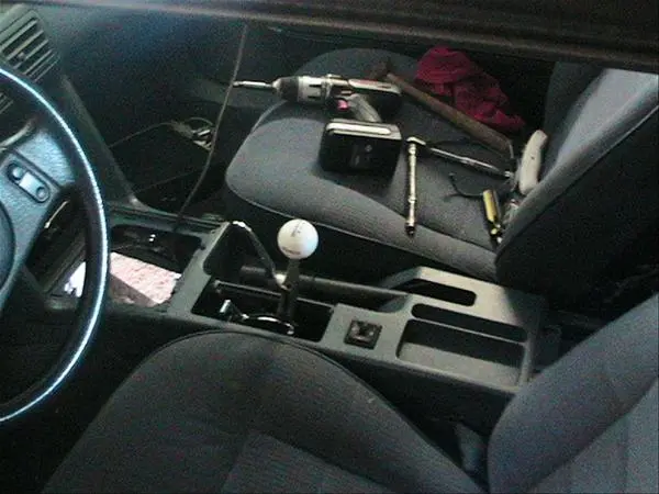

In order to get the shifter in the correct position, some trimming of the center console was necessary (all hidden when finished). You can see where here...

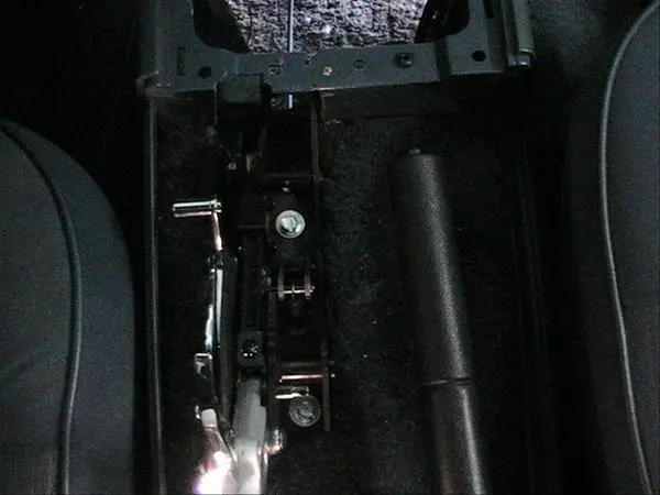

Here is the shifter bolted down. Be sure to trim all of the carpet/padding/insulation in order to get a tight fit against the body.

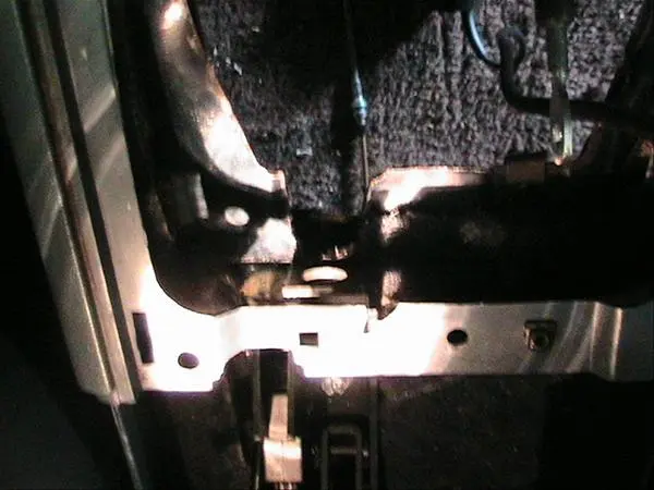

This pic is a bit hard to understand, but in order to get the cable to clear...I had to trim the bottom left mounting pad for the stock t-5 shifter boot in the frame.
A word to the wise...be careful when using the angle grinder with the guard repositioned and avoid contact with the fingers at all costs.
And here is the semi-finished result (I may trim the ashtray cover and fit it snug over top for a clean finish).

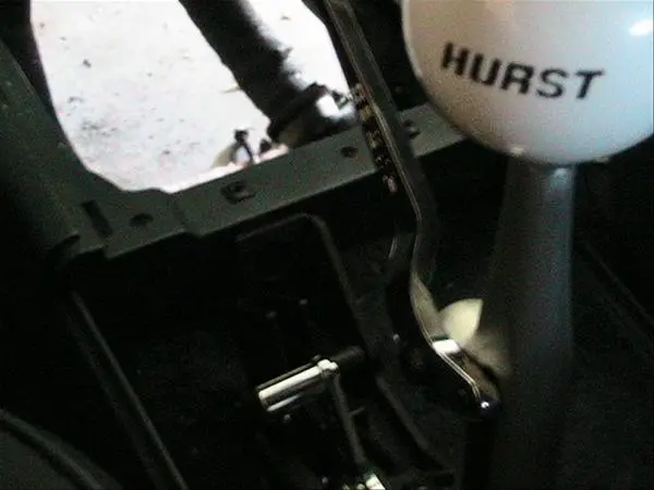

Park position...
Drive position...
And first gear position...

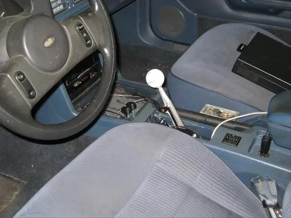

Ok, worked on it a little more today. I had to drop the back end of the tranny back down a bit to get all of the wiring harness connected. While I was at it, I hooked up the shifter cable.
Here is another pic of the shifter hooked up before I attached the cover plate...

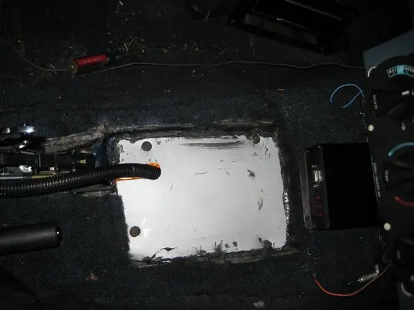

Here you can see the 22ga plate I fabbed up to cover the stock T-5 shifter hole. I had previously planned on recessing this area and mounting the baumann TCS...but I'm getting impatient and time is certainly not on my side. I'll likely end up spraying some expandable foam around shifter cable and Baumann harness. The rest simply has RTV silicone sealing everything up nicely.

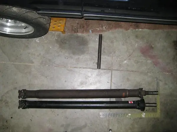

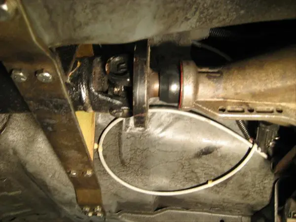

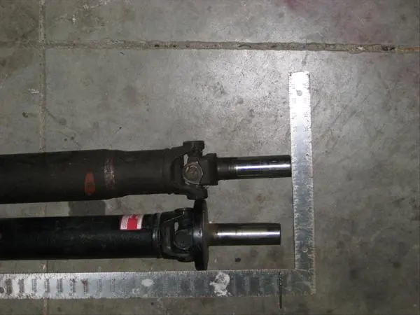

Here you can see the difference between the 99 V6 driveshaft I had been using for years and the shortened stock driveshaft that came with the kit.
How much it has been shortened is beyond me, but here you can see the length difference between the 99 v6 unit. The drill bit laying on the square is at the ~ 1.5" marking.
Here you can clearly see why the driveshaft needs to be shortened. While there is some more room the driveshaft can engage, it's certainly not much.

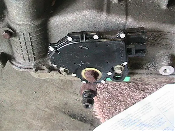

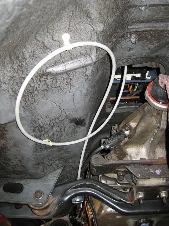

I ran into a few road-blocks when it came to re-attaching the exhaust. My downpipes ended up hitting the trans range sensor shift lever on the drivers side...and the ball-flange ended up hitting the pan on the other. The fix? I simply hacked the downpipes off at a straight portion of the pipe and I'll weld a small piece to extend the pipes down about 3" to clear later.
Here is a pic of where I mounted the trans-cooler.

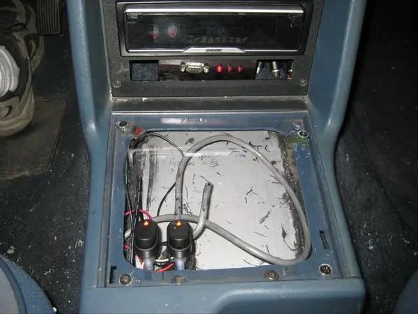

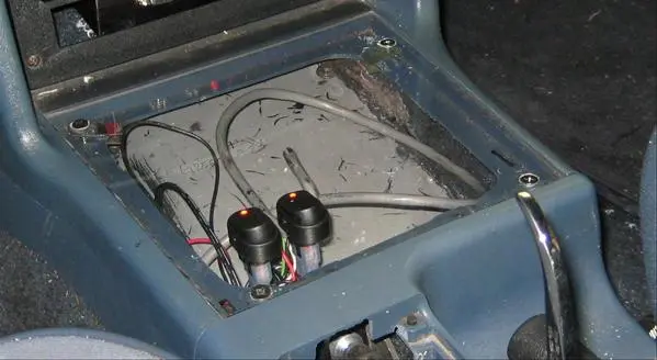

Ok, the shifter plate covering the manual shift hole is semi-completed. I'll end up taping a FORD blue oval on the back-side, shot-blast it to give it some texture and paint it black. As for the tranny leak, it ended up being the drain plug was a bit loose and slowly dripping after parking it. It never dripped while I was looking though...go figure!
Anyways, here are some pics of the new cover with the OD lockout and street/race tranny tune switch's.
