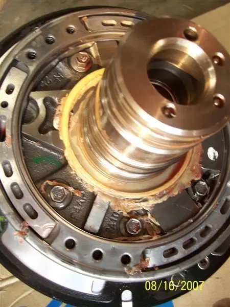

Here is the pump seal. See the black gasket around the outside. Their is also one that seals against the TQ ( looks like a timing cover seal) Look for any cracks in the converter
good deal thanks for the pics....Well, going to pull the trans (hopefully before the wknd) My trans guy said if it's the seal and or tc bushing he'll do it for between $10-$50 and do it right then and there. So that's good news. This guy races every weekend and specifically does race transmissions so I should have it in good hands and he can surely pick up on anything my untrained eye can easily overlook. Still can't believe this happened but hopefully I'll get it done and driving again soon!
Seals were all ok....turns out my converter is cracked....little more than a year old Precision industries 3200 stall...Clearly a failure in the case. Thing looks brand new w/ the exception of the crack. Spoke w/ jack from PI and he said send it back and he'll have a look at it. Will try to snap a pic of the area...Maybe a weak spot in the material of the front cover? Hopefully they are able to help me out....not like this is by any means a cheap part to replace.
