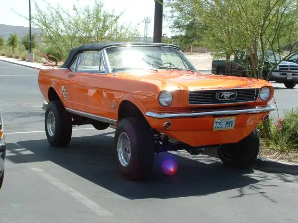

Just thought I would share what I saw an Home Depot the other day.
The entire JEEP chassis was used, including drivetrain. The Mustang body was gutted of all suspension, motor, etc, and electrical, steerintg, brakes, etc, were merged to work. Then the body was either welded or bolted to the Jeep frame. It didn't sit as high as the 65 posted above.
1badII said:
How do you do that with unibody cars? Do you just bolt the car onto the frame?
Use the body mounts on the 4x4 frame, and once the unibody is cleaned up, add some bracing, and then mount it to the body mount perches on the frame. Time consuming, but not terribly difficult. I've helped put a couple of XJ's on frames just like that.
