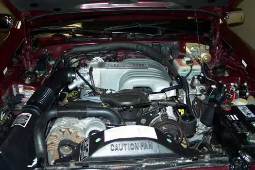

5.0 A Trim From A Lincoln Lsc, Fit On 88 Notch
mackblaze
Sep 19, 2012
15
Hanover MA
Found a cheap s trim that was previously on a Lincoln lsc 5.0. Just curious if anyone knows if it will bolt right up to my 88 notch with out any modifications? I would imagine its all the same brackets etc. as the standard 87-93 5.0 v1 s trim. Thanks in advance
I was under the impression those were non-ho motors with the intakes facing the drivers side. May be way off base here but if that's the case the brackets and piping may be wrong
Im thinking they are the same engine as the mustang,
I swore the same, except that they were HO engines. It's been probably fifteen years since I've had the opportunity to look under the hood of one though.
i was under the hood of a 90 lincoln and it was not a ho although it was a 5.0. intake was reversed. apparently the 88-92 Lincoln MK7 HO 5.0 will work though for alot of direct swap parts.
my bad i was arm deep in a 1990 5.0 crown vic... not the lincoln. but the mk7 is an ho engine.

so I should be in the clear as long as the intake was facing the right way/it came off of a h.o. motor? I cant find a Lsc specific kit from vortech anywhere so I'm guessing it is
an original foxbody kit.
I've had 3 of these cars...Even did a 351 swap on one. The 88-92 are H.O. 225hp roller motors. The 84-87 were not roller. The only difference is none ever came with Mass air.
