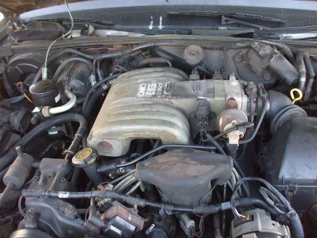

Right on thx Rich. I just ran the numbers on the intake and I keep coming up with a Thunderbird not a crown vic like I was told. I can just plug the new ECM from an HO engine in and only swap the spark plug wires that I am pretty sure of now. But if I have a Thunderbird 5.0 block along with the intake I may have the good pistons but sense I have the non HO firing order I am confused. Did the late 80's birds come with non HO engines?
So....the bad news. Thunderbirds didn't get the HO engine until the 1991 model year. That said, the intake was a lower profile design, with a curved inlet to clear the hood of the MN12 chassis
You've probably got one out of an mid-80's model....which would explain the reverse position of the manifold
Not only was this a non-HO engine, but it did not utilize a roller camshaft either. They also utilized cast aluminum pistons and not the forged or hypereutectic pistons found in the later HO blocks. Not a bad engine per se, but they were only rated at about 150hp....so you're not gonna be blowing the tires off that Ranger anytime soon.
One other thing that slipped my mind was that the E6SE cylinder heads (as well as the GT40's) use a longer (.708") AWSF/AGSF series plug. The E7TE heads found on the HO engines require a shorter (.460") ASF plug.
