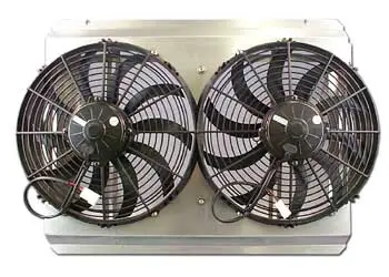

Why not run 2 smaller fans that are offset to each side? Then you'd have no prob with the water pump..
Good idea,
I have 21"s on the diagonal to work with and the only 10" fans i could find were big buck$ (if I wanted them to move enough air). Most only move 600-700 CFM. I was trying to get up in the 1600+ range. I just got onto the Flex-a-lite website and they have a decent low profile fan I'm sure will work. I was just trying to stay away from spending too much. Oh well, the stupid cooling fan will not be my car's weak point. We will call it an investment into air miles. :rolleyes:
